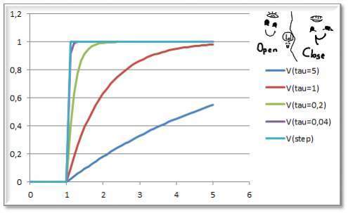

A constant voltage source has zero source resistance. The capacitor will charge 'instantly' (the exponential function turns into a step response) in circuit theory. The problem with 'instantly' is that the universe doesn't work that way (division by zero issues).
The electric field inside the capacitor will not change 'instantly' (instead change as a Heaviside function) causing a delta-like displacement current, magnetic field and induced emf to counter the rise of current. (Lenz's law) So we will have finite charge time.

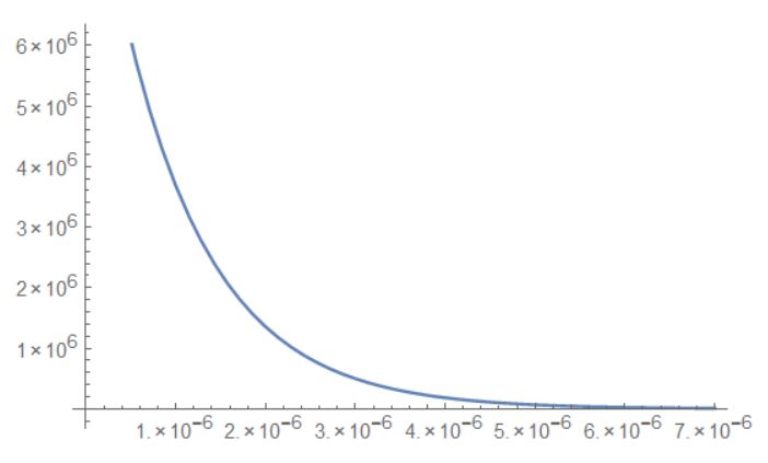

Yes, that reference shows it all, but I will work it out for my example. Assume V = 10 volts, C = 1 farad, and R = 1 microhm. The equation for the current supplied by the voltage source is
Substituting the parameters from above gives
and plotting the curve gives
Energy = charge times volts, so
In other words, the area under current curve with respect to time equals the charge. The total charge times the voltage is the work or energy the voltage source had to do to energize the capacitor to ten volts. If I specified the resistance to be one nanohm, the result would be the same. The shape of the curve would show a higher initial value at t = 0, but it would decline faster. The area under the current curve will be the same no matter what the resistance is. Ultimately, if the resistance is zero, the current would be a spike of infinite height and infinitesimal time with an area of 10. The energy stored in the capacitor is 50 joules instead of the 100 joules the voltage source expended. Therefore, for every two joules the voltage source outputs, only one joule is stored in the capacitor.
Now, can anyone do the problem I proposed in post #31?
Ratch
Ratch
