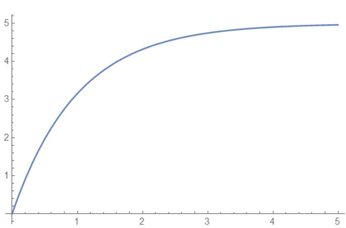

If the current is plotted, the result is
You can see the current is limited by the internal 2 ohm resistance to 5 amps. Now, what will the current plot be if the coil has no resistance? Can you figure it out? Give it a try.

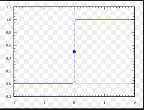

First of all, I specified a step function, not a pulse. That means that that current source will be 1 amp from t=0 until the end of time. In this problem, whether R = 0 or R=2, is insignificant in comparison to the large resistance of the current source. Let me modify the problem a little. Suppose the current source is one million volts in series with one million ohms of resistance. Now , what will the current curve look like? Assume that the inductor will act like an inductor. Don't get hung up on the magnetic field surrounding the inductor when current is present.

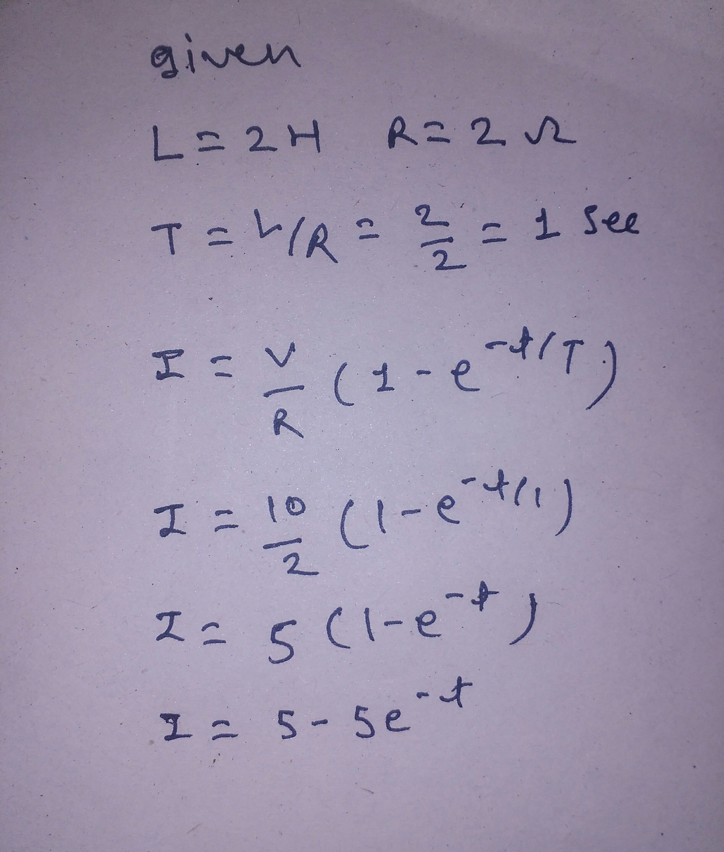

After Google search and reading book, I don't see the formula where I can find out time constant for inductor. There is formula for RC, RL combination And if I use same formula and put the value of r=0 than time constant t=L/R=2/0 which is not possible
As I said in post #25, everything you need to know is in post #21. Finding the limit of I as R approaches zero, we get
Finding the above limit if facilitated by using L'Hospital's Method, as described in any good calculus book.

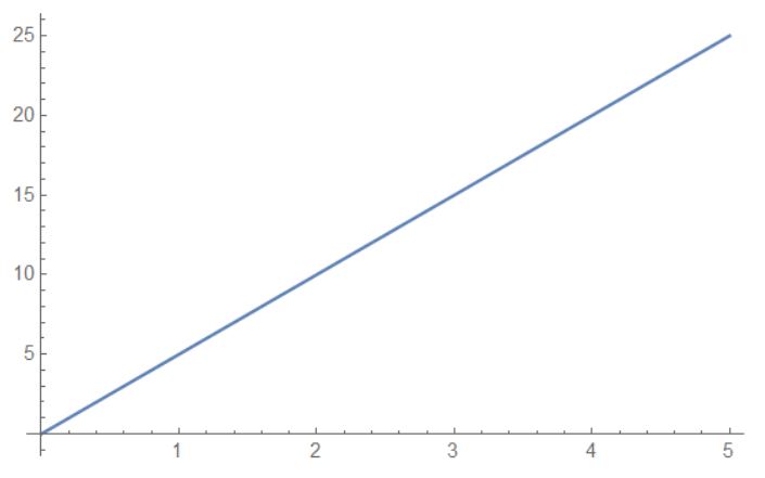

If V = 10 volts and L = 2 henrys, the current will be 5*t when R=0. Plotting the current curve when R=0.000001, we get.
As you can see, the value of the current is about 25 amps at the end of 5 seconds when R = 0 instead of 5 amps when R=2 ohms.
