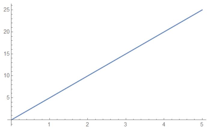

As I said in post #25, everything you need to know is in post #21. Finding the limit of I as R approaches zero, we get
Finding the above limit if facilitated by using L'Hospital's Method, as described in any good calculus book.
If V = 10 volts and L = 2 henrys, the current will be 5*t when R=0. Plotting the current curve when R=0.000001, we get.
As you can see, the value of the current is about 25 amps at the end of 5 seconds when R = 0 instead of 5 amps when R=2 ohms.

I = 5*t
di/dt=5 Amp per second
Current is increase at rate of 5 amp/sec

I = 5*t
That is correct if L=2 henrys, V=10 volts, and R=0.
From the graph and calculation, It is correct, but practically I don't think it is valid because current is increasing constantly.
Yes, the current is increasing in a linear manner with respect to time. When applying a DC voltage across a inductor with no limiting resistor (R = 0 , remember), you can expect the current to be constantly increasing.
Suppose if we calculate current for minute, or hours theoretically value of current will be too high.
There is no mathematical limit to the value the current can reach if you wait long enough. Of course, the inductor will burn out when its current limit is exceeded.
Can you tell me why our calculation is not valid practically?
You did not evaluate R as it approached zero in the denominator of your equation. You only used R to determine the time constant was infinity. You needed to evaluate R where it appears in every instance of the equation like I did.
