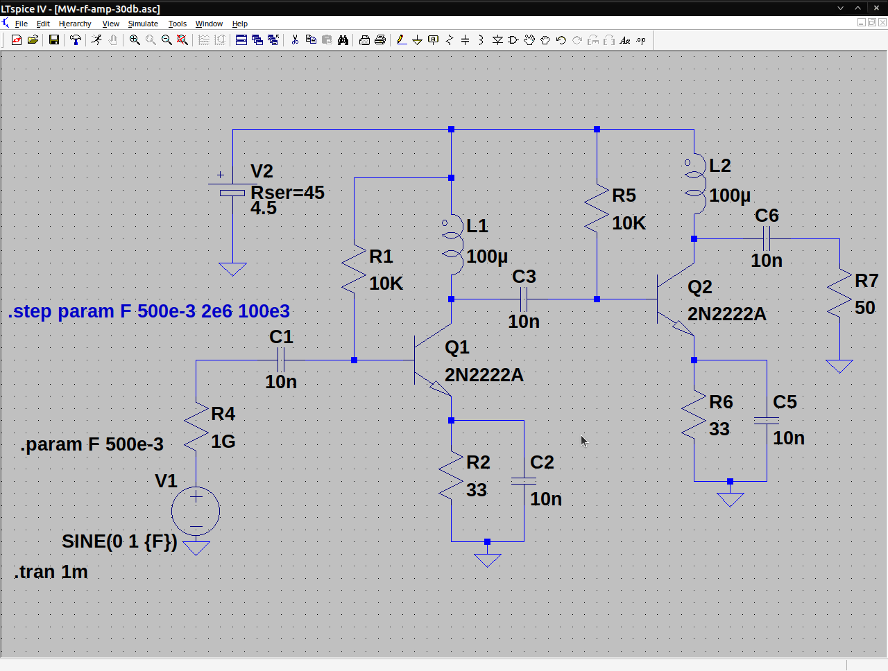

How can I calculate in LTspice the gain in decibels of my medium wave RF amplifier?

For voltage gain: 20*log(Vout/Vin)
For power gain: 10*log(Pout/Pin)
Chek the LTspice HELP file for the "Method of Middlebrook" to get the series of .meas statements for doing this in a .tran analysis

Why is the resistance of R4 so high that it does not pass any signal?
This design will not amplify properly for many reason. wrong impedances.

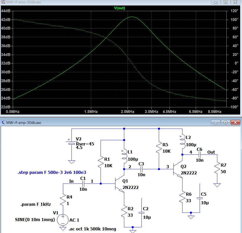

Below is the sim with some modifications:
I disconnected the emitter capacitors since they were apparently causing the amp to oscillate from the collector inductors.
I changed the input resistance to 1Ω (obviously not much signal will go through a 1G ohm resistor).
I did an AC analysis with an input of 1V, to give the small-signal (linearized) gain in dB.
What frequency response and gain did you want?
I was trying to make an MW RF amp with a gain of -30dB 30dB for listening to sferics at 500KHz and below. Thank you crutschow.
