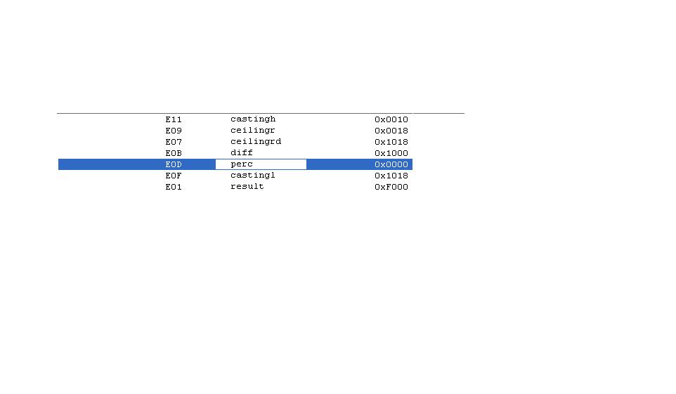

Hi! me again...i was doing a program on the 18LF4620 that requires me to calculate the percent difference between two integers.I was surprised to find out that although C18 allows multiplication and division of 'int' but when i was subtracting one from the other, it was only subtracting the Lower 8 bits.Weird huh?Is there any way with out using the 32 bit libraries(huge code size)?Except the manual way(8 bit operations)
Post the code. You have done something wrong. Sixteen bit maths works fine in C18.
Just worked it out.The problem was with the result that i was expecting.I cant calculate percentages with out using floating point math since the answer is going to be in decimals(after divisions) which cant be used with out teh math library so even after multiplying it with 100 i got zero.So what i have done is just calculated the difference and then did the other stuff in my labview vi(constituting the other part of the 'project').Thanks for you reply Mike.
Hi 3V0,here is the code.This is just a math test.
#include<p18f4620.h>
void main(void)
{	unsigned int result;
	unsigned int a=0x1018;
	unsigned int b=0x0018;
	unsigned int ceilingrd=0x1018;
	unsigned int ceilingr=0x0018;
	unsigned int diff,perc,castingl,castingh;
	castingl=(ceilingrd);
	castingh=(ceilingrd/256);
	diff=ceilingrd-ceilingr;
	result=b-a;
	perc=(diff/ceilingrd)*100;
	while(1);
If you see in MPLab Sim the variable perc is zero.
PS:3V0 can i PM you about a board that i made.Its basically a question(not technical) and may be useful to you.I would be really thankful.If you say yes the i will get back to you i 2 or 3 days..just wanted to ask since i have your attention.
