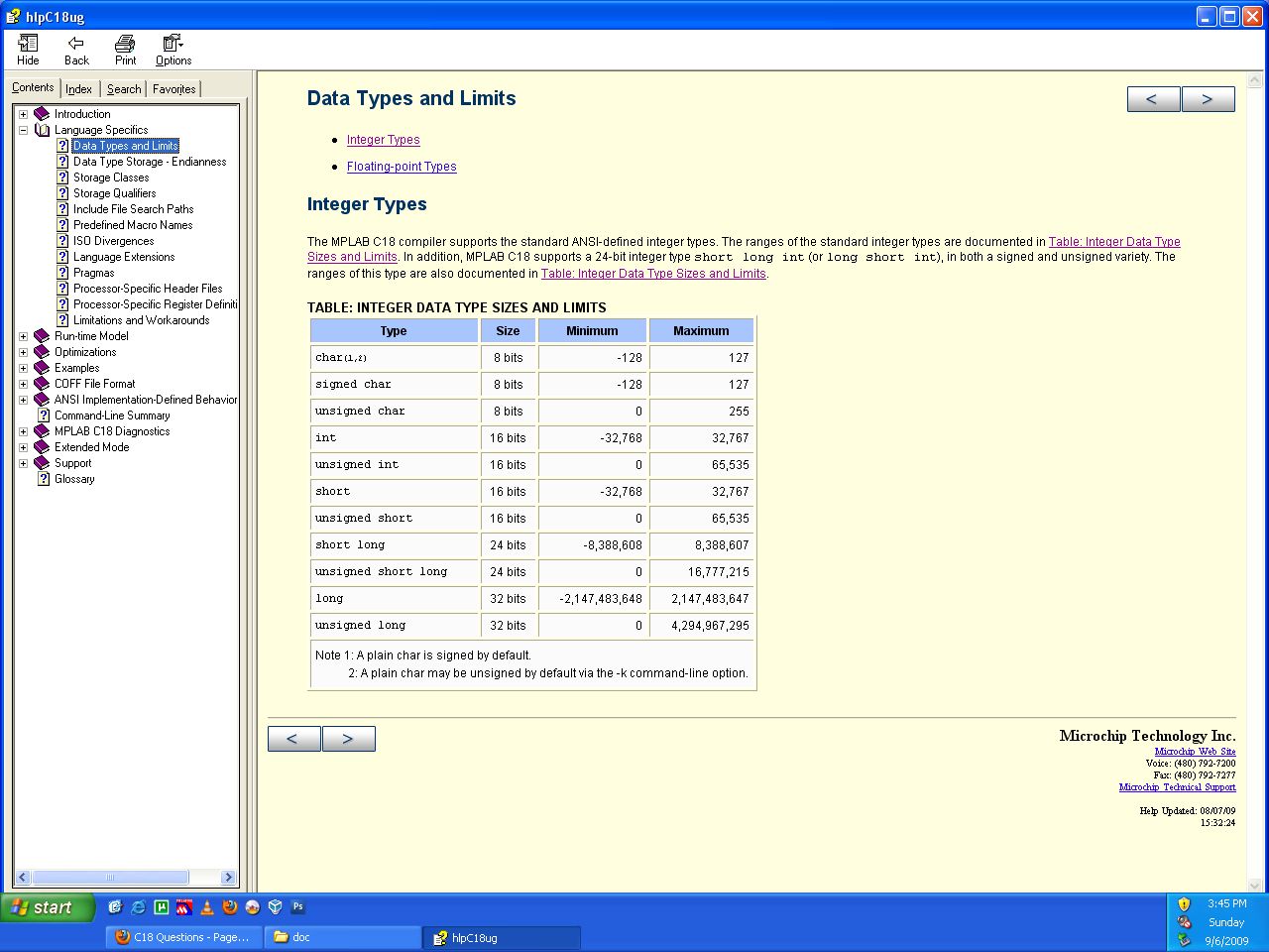

the odd part is, if i set ServoPulseLenth below 100 or so, it pulses as would be expected (I have an led on it right now) at a speed just visible to the eye, but if I increase that to 200 or over, it takes about 15 seconds between blinking. Somewhere there's a snag here.
edit: Ive narrowed it down. It starts going slow at 128, below that it pulses at what appears to be the correct speed.
are you sure at 128? i would suspect at 255 since most c18 functions contain char types. 254 should be a max limit ..
please be aware its 6am and i just read the latest post so i dont know what ya up to yet :D
ok a char is -128 to +127 and a unsigned char is 0-254 so maybe your issue is its a overrun where your value is more than the function can handle try to change it to a int or unsigned char
Yeah, that was the problem, thanks man. I've done PC programming, I shouldn't have missed a variable range thing, but oh well, haha. Now to work on timing.
ok a char is -128 to +127 and a unsigned char is 0-254 ...
Actually unsigned char is 0...255.
Max can be found with: max=2^bit_length-1. For 8 bits that makes 2^8=256 steps and max. value is 2^8-1 = 255.
You are correct sorry heh 1 digit off... thanks
