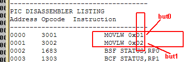

hi micro,
The 'label' But is just so us humans can read the program listing easier.:D
So we give the numbers for the buttons a label or a name.
When the assembler assembles the program listing, when it it see a label it replaces it with the number it represents.
EDIT:
Look at these images

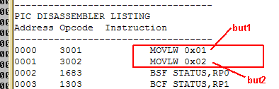

hi micro,
EDIT:

LOOK at the image the 01 and 02 are clearly visible
MOVLW 0x01 ; thats but0
MOVLW 0x02 ; thats but1
