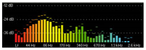

Do you want a colored frequency display like I show here or do you want the LEDs to light up a room?
Music has frequencies from 20Hz that is very low and you can feel it to 20kHz that is very high. The bass beat in some music is the loudest so a simple linear voltmeter shows it well.
BUT our hearing's sensitivity to loudness is not linear, it is logarithmic. Then an LM3915 logarithmic 10 LEDs driver should be used with a peak detector circuit since our sight needs an LED to be lighted for at least 30ms to be at full brightness.
You might need only one circuit for low frequencies, a second circuit for mid frequencies and a third circuit for high frequencies.
Here is the photo of a real time audio analyser:
