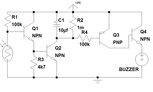

Any criticism is appreciated..lol...since Im just a fool hobbyist :). I'm a noob here and read in grade 10. So I've some question about this project.
You can laugh at me after looking at this image but I have no problem because Im a LEARNER so Im asking for your assistance.
NB: Another sorry for my bad English skill. I live nearby india.
Here is my questions. Look at the image, I wrote my questions on this image.
