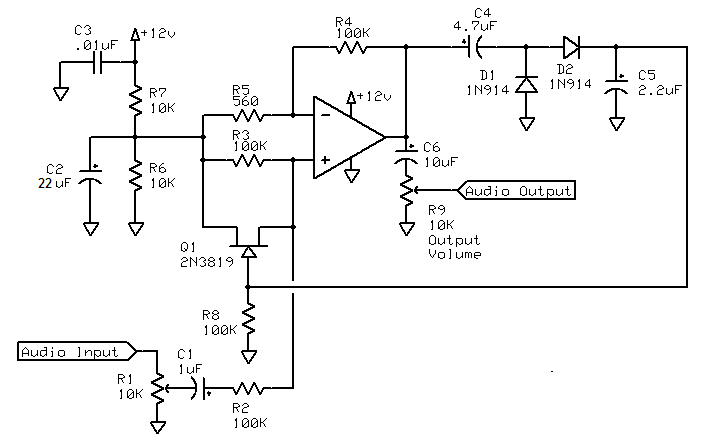

Look in Google for Audio Compressor Circuit. There used to be NE570, NE571 and NE572 ICs that worked well but they are obsolete. Most discrete circuits use a Jfet to attenuate signals that are too loud.
Audioguru:
I managed to locate some NE571's on eBay, might order some - but am leaning more to using the circuit using a TL072 with the FET and associated components. The only problem (for me) would be the split 15 V supply. Since this is being added to an existing circuit, I do not have the liberty of split supplies. Is it possible to use that design with a single supply?
Ken

Hi Ken,
When you say ". . .the circuit using a TL072 with the FET and associated components", what circuit do you mean?
You can indeed use a TL072 on a single supply--that's what the circuit from post #15 does, for instance (well, with a TL071 which I had in there but but that's just half a TL072*). In fact there's a sticky on this very topic which includes Audioguru's famous diagram explaining how it's done: https://www.electro-tech-online.com/threads/basic-opamp-circuits.35258/
Do you already have a schematic for the AGC portion?
* -- Truth be told I wound up using a 5532 which is why there was a compensation cap on the op-amp--Audioguru crossed that cap off the diagram though since a TL071/81 doesn't need it.
Cheers,
Torben
Here is a hard limiter circuit that uses a single supply voltage. It might not work if the Jfet is at its spec limits. I would use a Jfet with tighter limits like a 2N5485. This circuit is not optimised for low distortion.

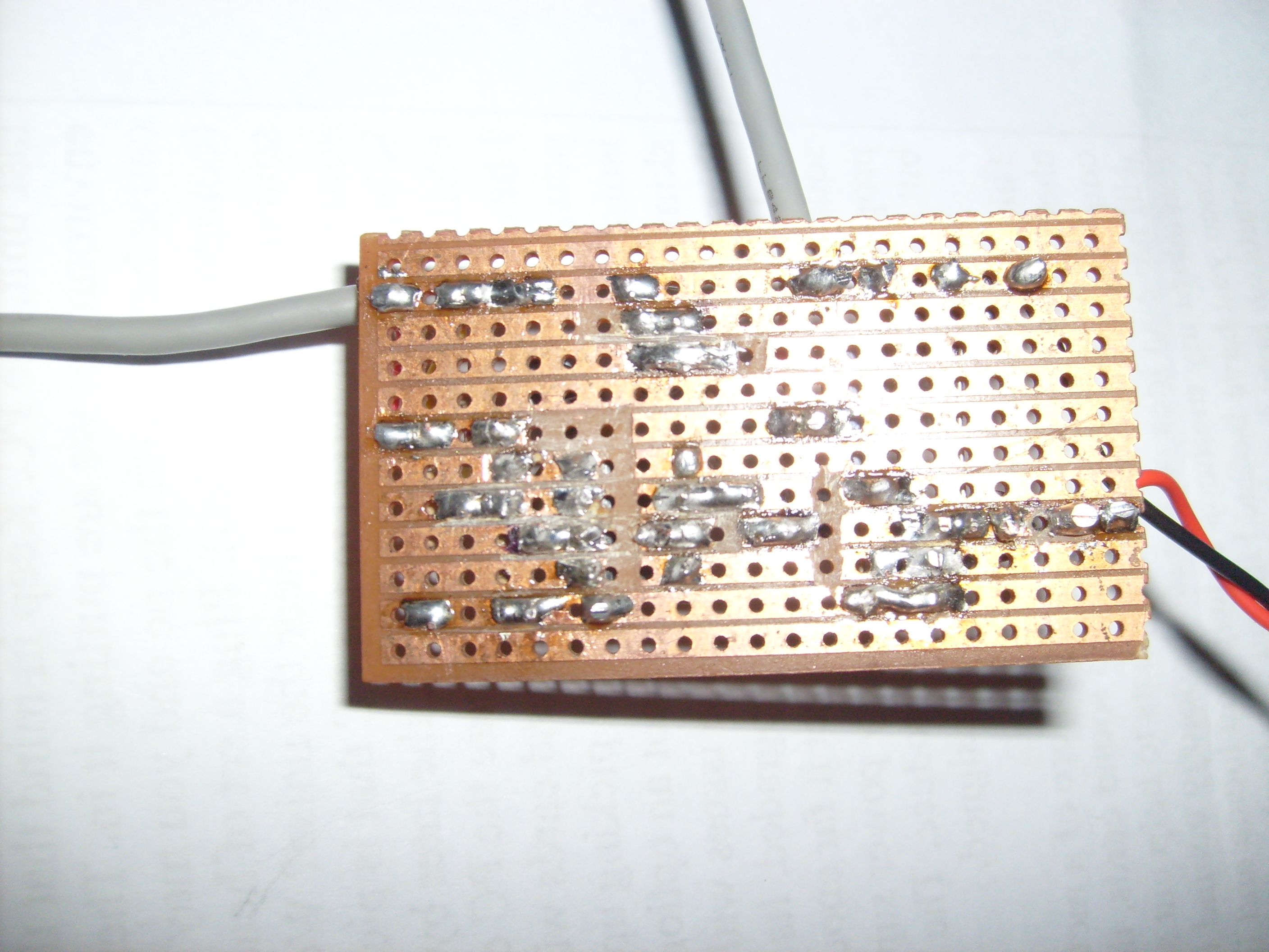

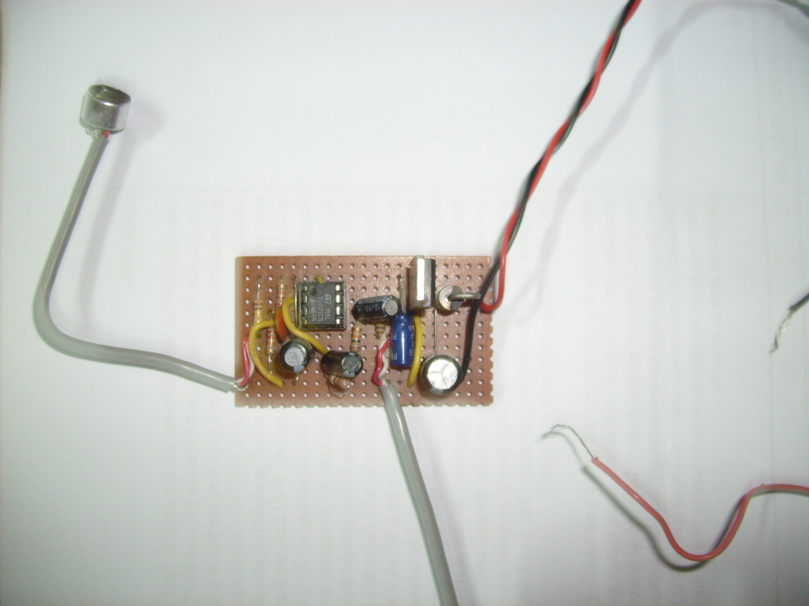

My circuit is not working : (
dear audio guru,
i have made this circuit as per schematics with TL071 and ur modifications, completed last night. Circuit seems working ok ass pre amp but it is not sensitive as i have to eat mic to get sound from my amplifier.
Circuit images are attached here with if you plz shed some light on it...
Basically i want to use it with my computer so that it can pic my voice commands from some distance but it is not working in that way : (
can i use simple a cell phone mic or a hand free mic in palce of this whole circuit.. i am thinking in this way ... but this circuit sould work what you say :)
thanks in advnace...
