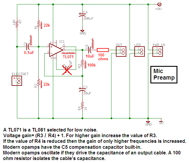

Basically the manager at a local radio shack asked if I could try and build him the following circuit...
He would like me to build him an ULTRA sensitive microphone circuit.
The circuit is for his wife.. for her job she uses a low power microphone
* THIS IS FOR A COMPUTER BY THE WAY *
She wants to be able to get up and walk around a small room while still being about to talk to her customers..
So the manager buys a small electret mic and gives it to me.. from what I knew at the time I told him that I will need an audio amp IC to amplify the sound going into the mic..
So I tell him the 386N amplifier should do..
I wire it up with a gain of 20 (The default gain) and the bass booster..
See Bottom Left Schematic on PAGE 5.
and hook it up to an 8:eek:hm: speaker.. and used a 9V battery
Ok, what I now need to do is interface it with the PC microphone port.. I notice my standard PC mic has a stero plug..
Question 1: What is each part of the plug connected to in the computer? Why would a mic with one input have a stero plug :confused:
I know I am going to need an attenuator or I will blow the PC input.. need help with that one..
Should I use LINE IN or MIC IN??
Basically I just want to get this thing hooked up the computer so that I can start working on making it as sensitive as possible..

You DON'T use a power amplifier like an LM386 for a microphone preamp, you use a preamplifier - either an opamp or discrete transistors.

**broken link removed** might help. One thing omitted is that you should bias your electret with a 4k7 from the ring terminal.

I'm not as experienced as everyone else here, but if you're going to use an OpAmp I really don't see what is so bad about the 741. You can split off the power supply voltage with a couple of 100k resistors and that can bias the non-inverting input with Vcc/2, then power the op amp off a single supply voltage. Capacitively couple your audio to the inverting input. A 100K pot feeding back to the inverted input from the output will allow you to adjust gain.
You'll still have all the other problems to deal with (a 100uF cap across the power supply will help with noise), but you WILL have a LOT of gain.
The 741 isn't a bad part. The TL071 is just better. It uses less current, has a lower input bias current, and 10X better large signal slew rate. IIRC, it also drives closer to the rails without distortion, and has half the noise.

Before you said the lady was going to talk to customers while walking around the room. Then the voice level from the mic will change all over the place and it s high sensitivity will pickup all kinds of noises.
I changed a few parts in your mic preamp to make it work properly.
EDIT: I corrected the formula to calculate the voltage gain.

OK,
I tried the setup with out your mods - thanks guru - and the results were astonishing to say the least.
I stood back about 20 feet and spoke with a normal voice.. the sound recorder picked it up as if i was standing right next to it..
I then went on an online game and asked people how the mic sounded and they all said about 8/10 for clearness :D

Also It was faintly picking up a bit of radio noise, would enclosing in a conduct project box fix this?
The mic must have a shielded audio cable or very short wires.
The preamp circuit should have a pcb or be made on stripboard with short wiring.
Don't use a breadboard which picks up all kinds of interference by its long wires.
I have many preamp circuits in plastic boxes and they are fine. Use a metal box connected with a wire to the circuit's ground to stop strong local stations from interfering.

By the way, if it isnt too much to ask, what is the gain set at with the 100K resistor?

Hi Peter,
My schematic said wrongly how to calculate the gain of the opamp. It is (R3/R4) + 1. So the voltage gain is 101. I corrected my schematic.
With that much gain the frequency response of a TL071 or TL081 is flat up to 32kHz. If the voltage gain is higher at 1000 then the frequencies above 3.2kHz will be reduced.
