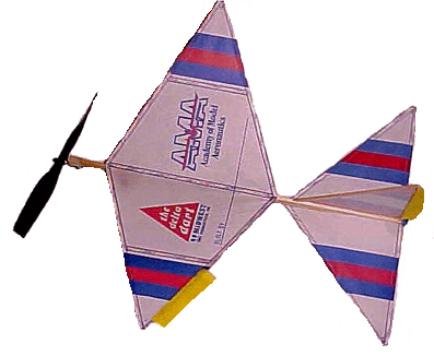

60 hours is short. I would go for a flight stabilizer (IR-based, NOT gyro based which requires extra investment and processing complexity which your limitations and timeline will greatly limit).
Just aim for making the system be able to hold a constant bank angle (a fixed roll angle ) with fixed elevator pitch so that the plane flies in a circle on it's own (human pilot to take off and land). It may not seem like it, but that alone would wow a lot of people.
Use a flat foam flyer, or a slow/park flyer based wings bolted to a stick. They are cheap, easy to build, easy to fly, easy to land and usually stable. You don't want it too nimble because IR thermopiles can have a enough response time that the agility of the plane is too high and you get oscillations due to the phase delay produced.
