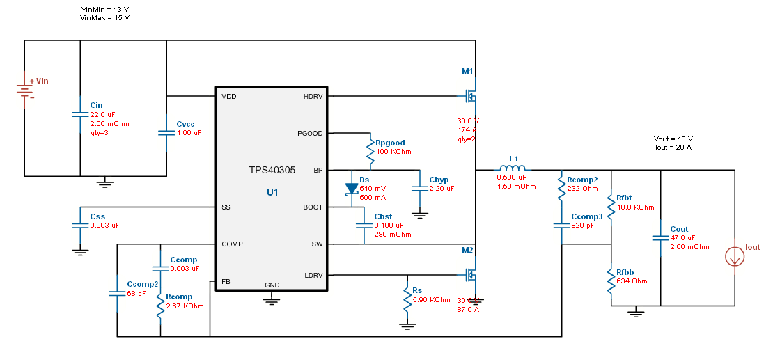

Here is a switching power supply. Sorry it is not simple. It should be 96% efficient so there will be only 8 watts of loss.
A step in the right direction :)

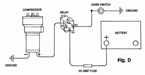

This is what I'm working with (don't judge the application..)
This is a musical air horn system, the compressor is 12v - the problem is, even with the car not running, it's getting more than 12v, which makes it faster than it should be.
In this application the regulator I need would only be working less than 10 seconds at a time. Does this change the solutions I was given above being it's a momentary application?
If I use a regulator where the the activation input is 13v, that'd be fine, I can accept not using the horn if the car isn't running.
