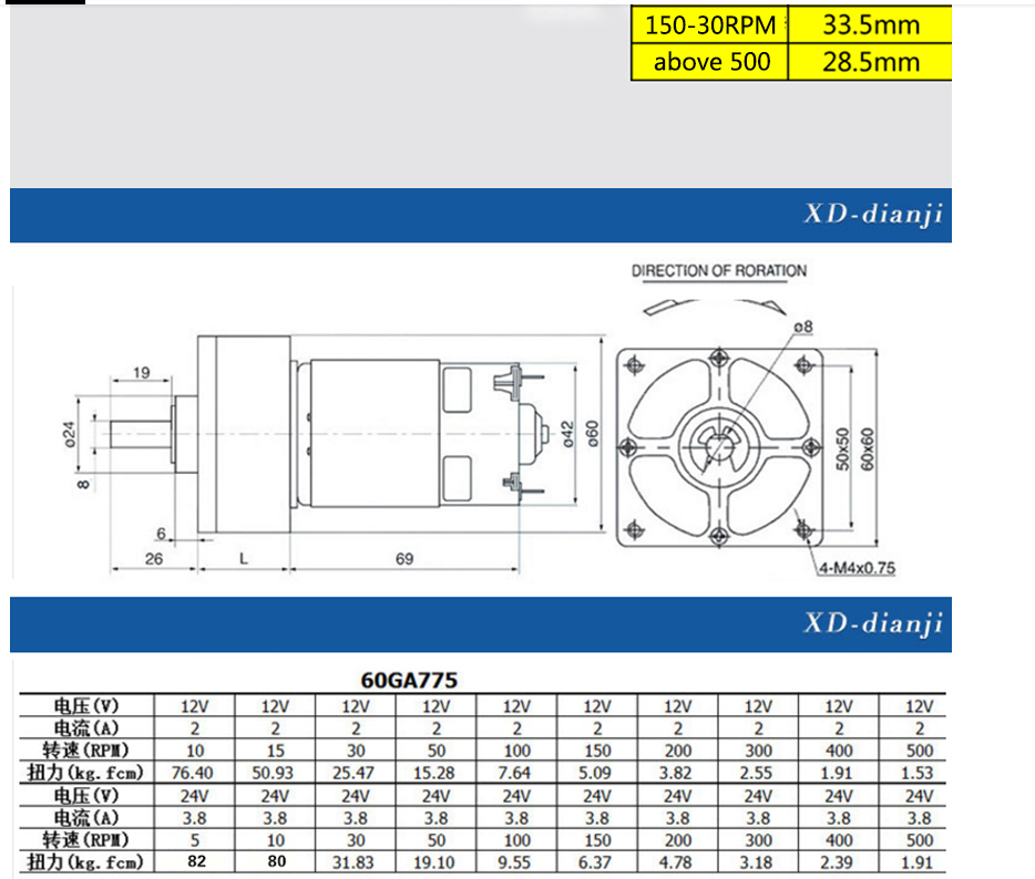

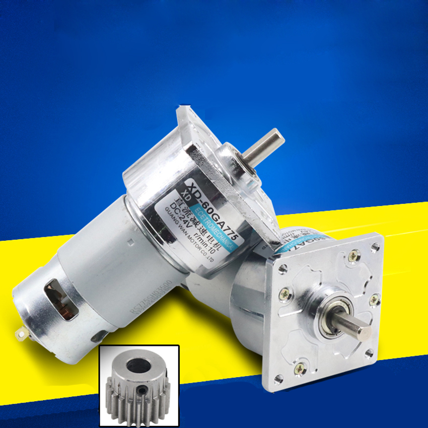

I bought a motor on aliexpress, which from the specs states 400rpm at 12v. The sticker and the specs seem wrong. I've measured it at around 100rpm at 12v.
My understanding is voltage makes it spins faster but it's current which causes it to heat, so as long as the bearings and gearbox can sustain say 48v to give 400rpm then all I have to watch is that the current doesn't rise above the rated amount, 2A.
Is this correct, or should I be complaining to the seller that the gearbox is way off spec?!

From the data listing different motor-gearbox combinations, I'd say they just sent the wrong one or it is mis-labelled.
100 RPM output @ 12V is right in the middle of the list; 400 RPM is next to last.
I agree with rjenkinsgb that they likely sent you the wrong motor.
But there may be a way to check that. In the upper right corner of the spec sheet they show that a dimension changes for different speeds. The tabble is not labeled, but I suspect thast it is dimmension L, since that is the only variable on the drawing.
Unfortuanately, the two speed brackets don't include 400RPM. But I'd check that dimension anyway.
