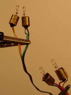

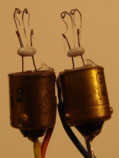

Since we're still playing with ideas, I thought I'd try the hot wire flow sensor I mentioned earlier. I used 4 pilot lamps (#1815's: 14V@2.8W...I had a bunch) in a full bridge configuration. The glass envelopes were removed to expose the bare filaments. Two of the lamps are in the air flow path, and two are in still, ambient air. The saw teeth are puffs during a continuous blow. I just ran the output to an O-scope, but it could be fed to the differential inputs of an op-amp for offset and gain adjustment. A higher bridge drive voltage (4v) gave a higher output and was more sensitive, but a longer decay.
Ken

I have seen the broken bulb idea before, but instead of two they used a single bulb. The circuit preheated it to certain point with a little voltage (maybe as a point of reference), and then if the wind blew the circuit measured the resistance change across the filament.
I tried to find the original schematic but I failed, anyway I guess all of you are experts so making the circuit is piece of cake!
Menticol,
Which circuit were you looking for? If it was the single-bulb detector, I included a link to it in my first post in this thread. The four-bulb heated-bridge gives twice output of the single-bulb and two-bulb, and also compensates the zero point for different ambient temperatures, as does the two-bulb half-bridge.
Ken
