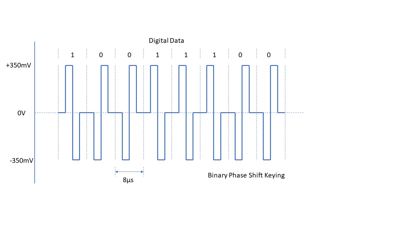

Hello,
The following is a Data waveform modulated as shown in the image. Can someone guide me how to generate the waveform using a MCU / FPGA. I am trying to figure out how to jump between the voltage rails quick enough to generate an acceptable waveform.
The only 'slight' difficulty is the three level waveform, centred about zero volts - you will need a little circuitry to create that, and probably two I/O pins from a processor to produce the three levels.
The waveform itself is simple enough, and easily done in assembler with simple loop delays - with pulse widths of 8uS a 4MHz PIC could easily generate it.
Tapajit, where the heck did you find that old waveform? It is not very BW efficient and not exactly called BPSK either. It is BPSK + RZ (return to zero) which doubles the bandwidth consumed.

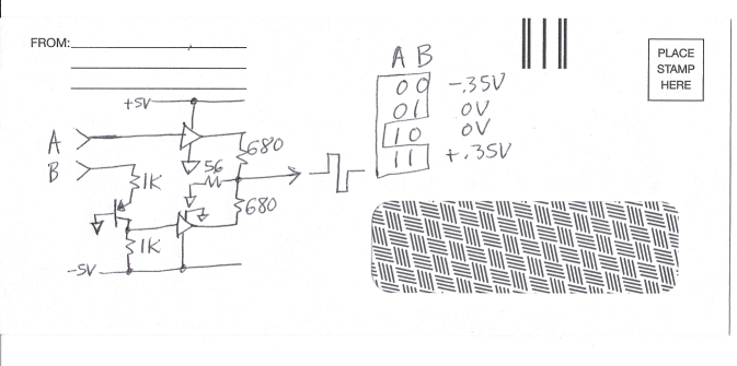

Quick idea on an envelope. lol
From computer or FPGA. (A, B) Digital data 0/5V could be 0/3.3.
Transistor changes 0/5V to = -5V/0V. Level shifter.
IC1 is simple buffer (could be inverter)
IC2 is also simple buffer BUT the supply is connected to 0V and the "ground pin" is connected to -5V. (output is 0 and -5V)
I chose resistors to get near 50 ohms. Could choose higher values. (if 3.3V supply you will need to change the 680 resistors.
AB=00= -0.35V if I did the math right.
AB=11= +0.35V
AB=01 or 10 you will get 0V.
There are other ways. Maybe 30 different ways. You will need to update the outputs every 2uS.
p.s. looks like I did not do the math right. (voltage divider, 5V to 0.35V, simple math for some one awake)(resistor to +5V and resistor to ground, the third resistor is in parallel with the 56 ohm resistor)

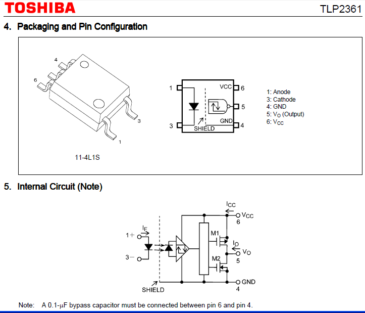

Here is a part.
Many isolators only pull down. This type pulls up and down! I think you can pull 1 mA with out a problem.
The delay through the part is about 50nS. The output rise and fall time is 3nS.
You should drive the LED with 2 to 6mA.
Power supply pins should have a 0.1uf cap.
When the LED is on the output is low. When there is no LED current the output is high.

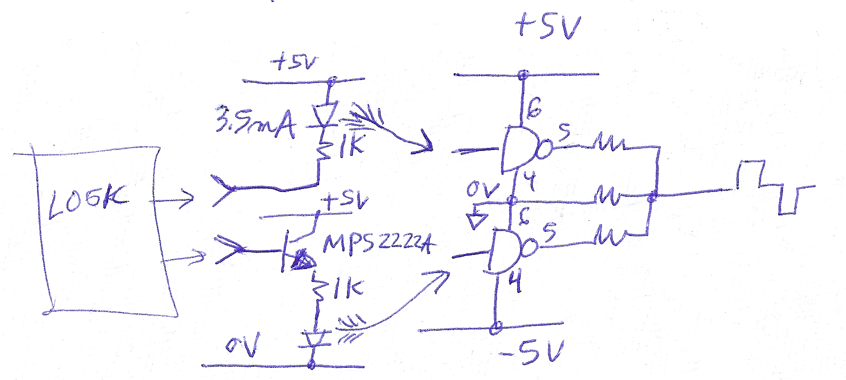

On the input side:
(top) If input = 0 then the LED current is 3.5mA and the output is low.
If the input = 1 then the LED current is 0 and the output is high.
(bottom) If input = 0 the LED current is 0 and the output is high.
If the input = 1 the LED current is 3mA and the output is low.
On the output side: (about the same as last time)
There is a +5V, 0V and -5V supply
One isolator has an output of 0 or 5V.
The other isolator has an output of -5V or 0V.
Input 0,0 output = 0V
Input 1,0 output = +0.35V
Input 0,1 output = -0.35V
Input 1,1 output = about 0V (not used)
