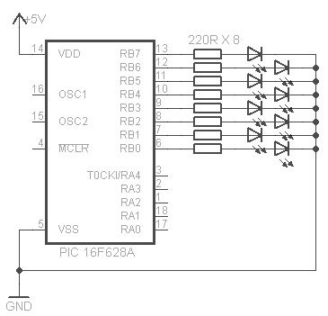

I'll show my code.
I'm doing PWM in ISR.I'm using 16F88 4Mhz.8 LEDs are connected to PORTB via resisters thats it.

Hi Suraj,
It's difficult to help you with your problem without schematic and well commented code.
Mike
Hi Mike thanks for your concern.I have attached my code.Can you tell is it ok or what changes do I have to do?What method do you use if you are doing a knight rider on direct I/O port?
Hi Suraj,
Now I see what you're doin'. Thanks.
I think your problem is that you're counting pwm "steps" rather than complete "frames" for your LED array update timing. Your update timing delays need to be in increments of your 12.8 msec frame rate which means you can update your LED array with new PWM values only up to the frame rate which is 78.125 times per second.
I would use duty_cycle == 0 for synchronizing LED array updates as shown in the following example and I think I would use a faster refresh rate to allow finer update intervals. Here's an example ISR using 100 pwm "steps" and 50 usec interrupt intervals for a 200 Hz refresh rate and a 5 msec frame rate;

Hi Mike I studied your program its very clever.I have a problem.I'm using 4Mhz not 8Mhz.
I adjusted your program Is this settings ok?
XT = 4Mhz
Interrupts = 100uS
Levels = 100
Frame Rate = 10000uS = 10mS
PWM Frequency = 100Mhz
Whats the advantage using higher PWM frequency Mike? Is 60 PWM frequency do you recommend?

Hi Mike, K8LH last night I checked on a real hardware your code worked perfectly.You need to uncomment that (xorlw 0ffh) after that it worked.I'm really really happy now.Thanks again for the support.
