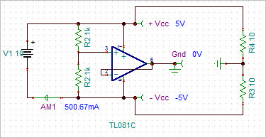

If your ±3.3VDC supply will go to +10VDC, you could construct this OpAmp based dual supply (virtual ground) generator:
R3 & R4 are just dummy loads to demonstrate current capacity (TL081C will tolerate a 1A load). Also note V1 source is isolated from load ground.
<EDIT> Removed the unnecessary ground from between R1 & R2!
