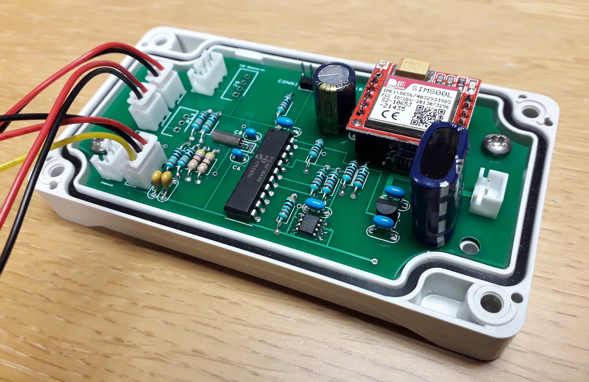

OK, as an example, here's the board I'm currently playing with, the capacitor to the left of the SIM800L is a 1000uF, with a 0.1uF across it, close to the supply pins for the module. The tall capacitor at the right is a 1F 'BEST' capacitor, to provide the current pulses that the battery itself can't, and is directly across the incoming battery supply. The power to the SIM800 is switched using a dual-FET, which is a SM device under the module - the 1000uF is on the output side of that switch. The other 8 pin SM chip is an I2C FRAM, used for storing various settings, which can be updated via a webpage and MYSQL database - when the board connects to the Internet it downloads the time (to reset it's clock) and checks for a settings update, and downloads it if there is one - once that's done, it marks the update as done in the database so as not to do it again. So far it's all going pretty well - I've currently got one transmitting every 8 hours, running from a single 18650, to see how long it lasts.
But as for the OP, it's almost certainly a power problem, which is always the case with GSM projects.
I took this picture with my phone, I'm pretty impressed - you can read the number on the PIC really well :D
Not gonna lie Nigel, the way that board is routed and fits so snugly in that housing is satisfying. :)
I'd like to take credit for it - but I copied the layout from an existing board, manually as I didn't have the files for it, but I did have a bare PCB of the right size and shape so simply measured it and made my own version of it. It's a bit tricky getting the corners dead right, but I managed it after a couple of tries.
I then saved it as a template, so I can use the same outline whenever I want.
I must admit when the boards came back from China I was VERY pleased when it dropped in perfectly :D
