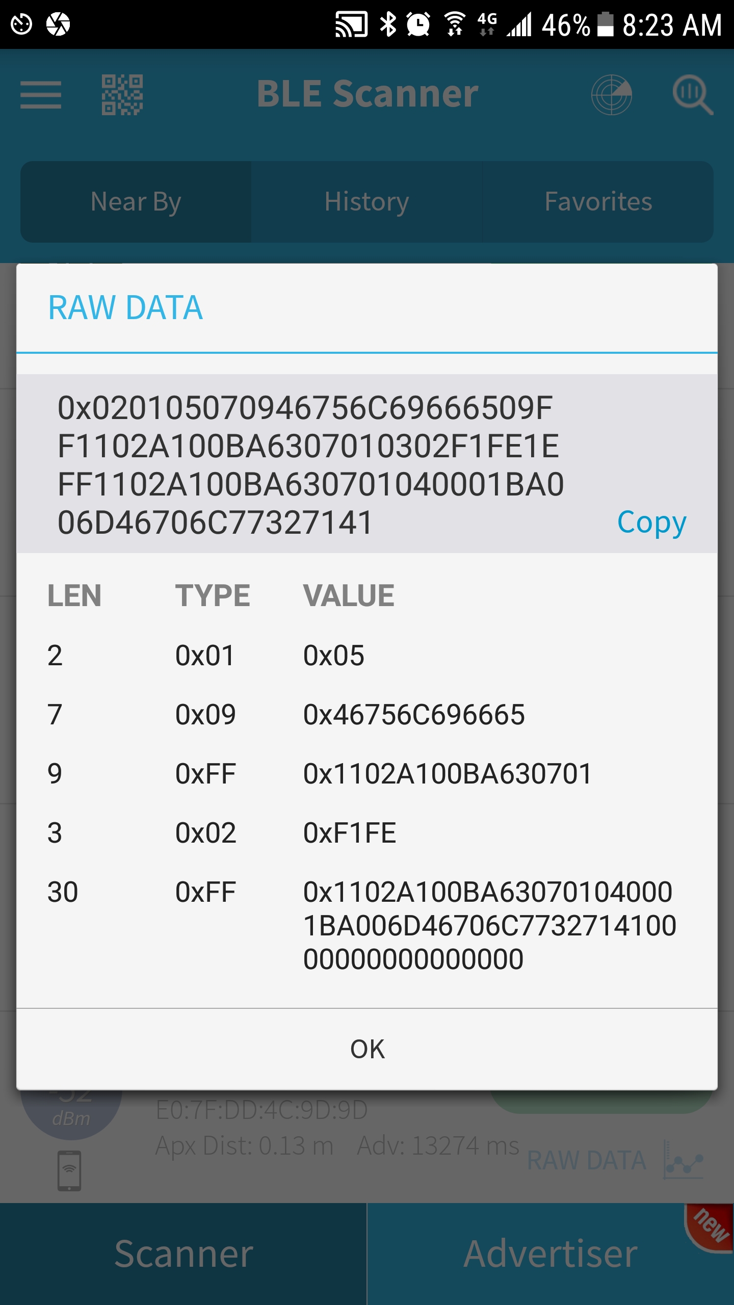

So first I have successfully scanned and found the device(device #1 ) with a generic scanner which shows a device mac address and a string as in img1, called the raw data but what is all this and is it encrypted?

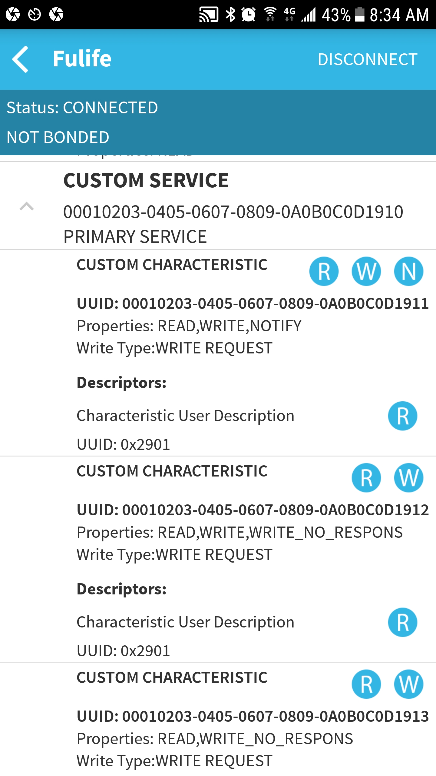

Next I click the connect button, and it pulls up all these table such as a device info table which has things like firmware string uuid, manufacture string uuid, model string uuid, revision string uuid .... next is generic access string with device name uuid and appearance uuid.... all, naturally, read only. Next is the custom service table, a little more interesting where there are 3 tables all named custom characteristics and are all also read write, but also the third one is notify too.

I don't think it is encrypted, as much as just being a binary / ascii mixed protocol.
The second and 5th lines contain what appear to be ASCII characters, represented in hex as all the data is in that image.
The second could be the maker?
The fragment in the 5th does not make any sense, it could just be chance numbers - or an access key or password of some sort:
46 75 6C 69 66 65
Fulife
6D 46 70 6C 77 32 71 41
mFplw2qA
