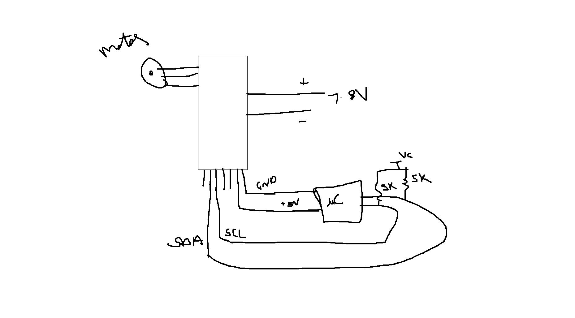

BLDC motor speed control...

You do know that you may be sending data to fast for the Atmel atmega 8au to read it.
Potentiometer Test and Debug
The brushless motor and driver can be tested by connecting GND to the SCL pin and applying a
fixed analog voltage from 0V to 5V on the SDA pin using a 1kohm – 100kohm potentiometer.
The driver will enter test mode on start-up if SCL is connected to GND and start the motor at a
speed depending on the voltage on the SDA pin. This can be used to simply test the
functionality of the motor driver and the brushless motor.
Have you tried this?

You need to adjust the I2C clock speed. It's in the SSPADD register. Take out the PIC16F877A datasheet and read the calculation part for the I2C speed.
You can try 5kHz at the start. Or, look at the manual for the motor controller.
I don't see it being 400khz it's probably using arduino code which the libraries are much slower then that start slow as picbits said Experiment
Experiment
Hi again,
The BLDC is working perfect now and i have added ADC control..
#include <htc.h>
__CONFIG(LVP_OFF & BOREN_OFF & PWRTE_ON & WDTE_OFF & FOSC_HS);
#define _XTAL_FREQ 20000000
#define SDATA RC4
#define SCLK RC3
void I2C_init(),I2C_start(void),I2C_write(char x), I2cSTOP(void);
void i2c_Wait(void);
adc();
void main(void){
 TRISA = 0xff ;
ADCON1=0b00000000;
ADCON0=0b10000001;//000 = channel 0, (RA0/AN0)
	ADIF=0;
	TRISC3=1; //direction to input have be changed
	TRISC4=1;
TRISC5=0;
RC5=0;
RC5=1;
__delay_ms(500);
RC5=0;
unsigned int a;
while(1){
 a=adc();
   I2C_init();
__delay_ms(50);
	I2C_start();
	I2C_write(0x12);//esc default addr
	I2C_write(a);//testing speed 0-255
   I2cSTOP();
void I2C_init(void)
  SSPCON = 0x38;      // set I2C master mode
 SSPCON2 = 0x00;
SSPADD = 0x0C;  //400KHZ  20MHz xtal
SSPSTAT|=0X80;
 PSPIF=0;      // clear SSPIF interrupt flag
 BCLIF=0;      // clear bus collision flag
void I2C_start(void)
    i2c_Wait();
    SEN=1;
 void I2C_write(char x){
	i2c_Wait();
SSPBUF=x;
void i2c_Wait(void){
    while((SSPCON2 & 0X1F || (SSPSTAT & 0X04)));
void I2cSTOP(void)
    i2c_Wait();
    PEN=1;
adc(){
	__delay_us(10);
GO_DONE=1;
	__delay_us(10);
return ADRESH;
