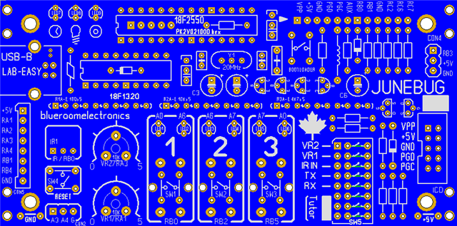

If you want me to send you a free Junebug PCB. Don't bother if you don't need it, just offering.
PS your code shows, but your schematics / photos whatever don't.
