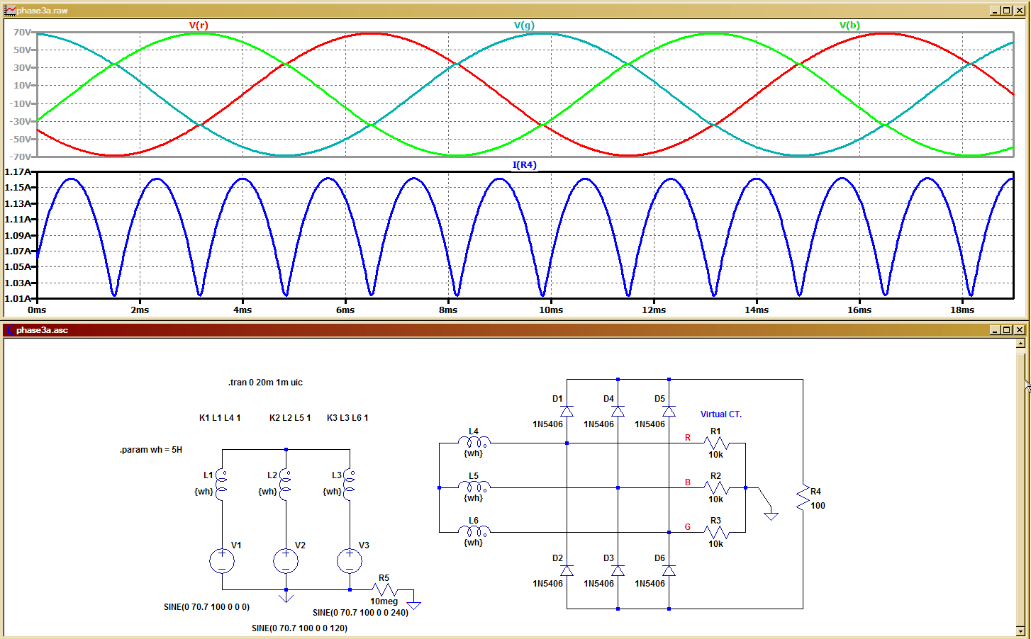

hi T,
This method uses a resistive virtual centre point for your measurements.
The Winding inductance and frequency I have chosen are arbitrary just for the Sim.

Thanks for the simulation.. very neat job as always. I'll have to consider rectifier and single resistor (like shortbus= suggested, and you simulated). At least try it. I wan't to measure all phases anyway, but the load would be is easier to control with a single resistor..

hi T,
The 3, 10K's are only there to provide a 'common' point , you asked in your 1st post 'can I use the centre point of the windings', using a virtual common centre point, you can.
The 100R is the Sim load resistor.
The load resistor 'value' could be controlled by using NMOS FET's and Gate opto couplers to give load isolation, say PWM.

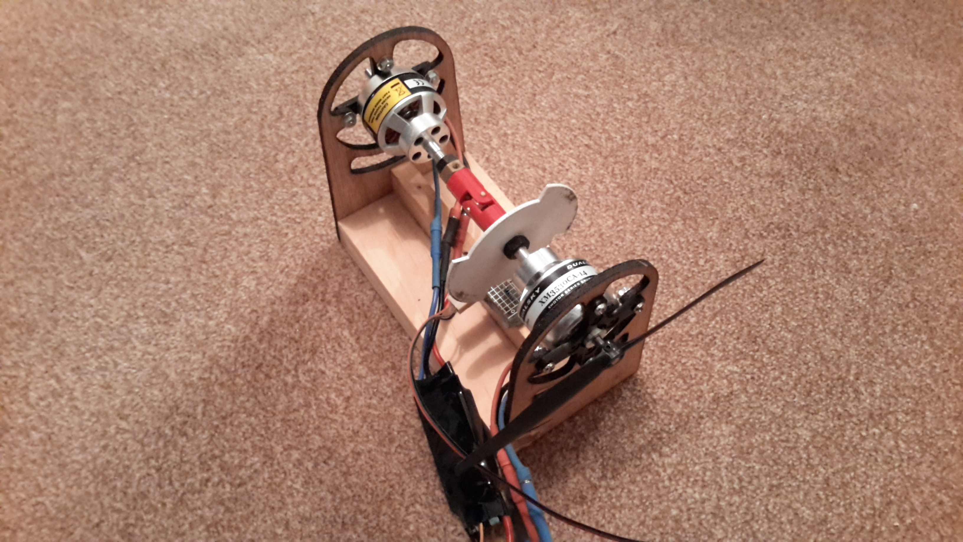

Here is a photo of my first setup. I don't have a good rig for the motors yet. It is "under construction".. just had to keep the motors down by hand.. squirmly setup :) Sorry I did not get a picture of the scope screen. The coupling is a simple plastic tube that fits snugly to the two pinions.
That small ESC is supposed to give 60A continuous.. I'm "little" suspicious about that. We have backups.. so I will test it to the limit.

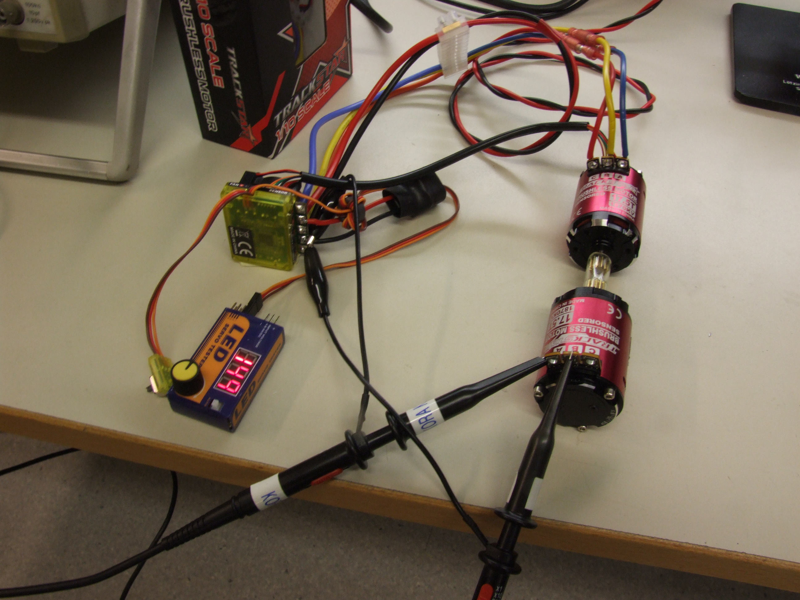

I did a similar thing a while ago. With 2 250W motors driven at 12V I calculated 175W going in and 125W coming out. Therefore, 25W loss in each motor or an efficiency of around (I think I calculated) 84%. I also tried full wave rectification but the overheating problems meant it was unusable. The heating is because you only draw current near the peak of the voltage wave and therefore you draw high current for short periods and have huge I²R losses.
Edit, found a pic of the setup I used.
Thank you for your replies ! Thank you Mike. I am planning to use this for fatigue testing of BLDC motors (250W) - It will run for at least a couple of hrs continuously. If suppose I provide regenerative circuit or resistance bank and provide cooling using industrial fan, can we get rid of heating problem?
If you use a resistive load then heating shouldn't be a problem. From memory I used three 50W 3Ω resistors in a star (Y) formation. I think it was these resistors.
