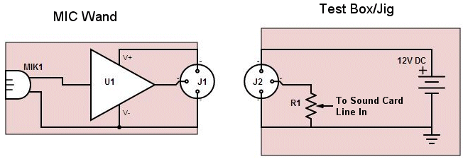

Man am I happy I was brought to the woodshed re: my post about your circuit. Best stupid mistake I ever made. Once I got it running in LTS its beauty became apparent. It runs on a single supply and has a Pi filter supplying the MIC bias. Clever!
The pic below shows my intended application. The R on the output of my ckts is a pot that will be in my test box/jig. I will be measuring speakers and feeding to a sound card line-in.

For my purposes, what fixed gain would you suggest for your circuit and what value pot would be best to least affect the FR with volume changes? You see, I cannot put a pot in the feedback loop of the OPA. Won't fit in the wand.

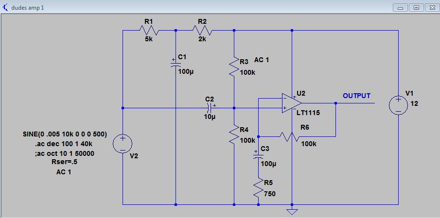

Given the 10k impedance of the MIC, would it make sense to take the positive side of C1 and move it to the junction of R7 and C3? That way the combined resistance of R1 and R7 will be looking at C1 for a lower f3. But I don't know about any interaction with C3 or the MIC.
Is there any magic re: the 100k values for R4 and R5? Could they be higher or lower for a lower noise contribution?

Come to think about it you won't have the adjustment pot either. So here is one with fixed gain that should run.
They make really small ones, but if you need to adjust it often back at the computer might be best. Maybe a small amplifier stage with a volume control. The input on sound cards vary a lot so just trying to pick a pot might not work.
The mic needs the resistance to develop the signal across. It wouldn't be able to drive C3.
No real magic within reason. Lower would be better for noise, but reduces the output from the mic. 100k is kind of a compromise, but 120k would be no problem.
There are better op amps for very low noise and distortion.

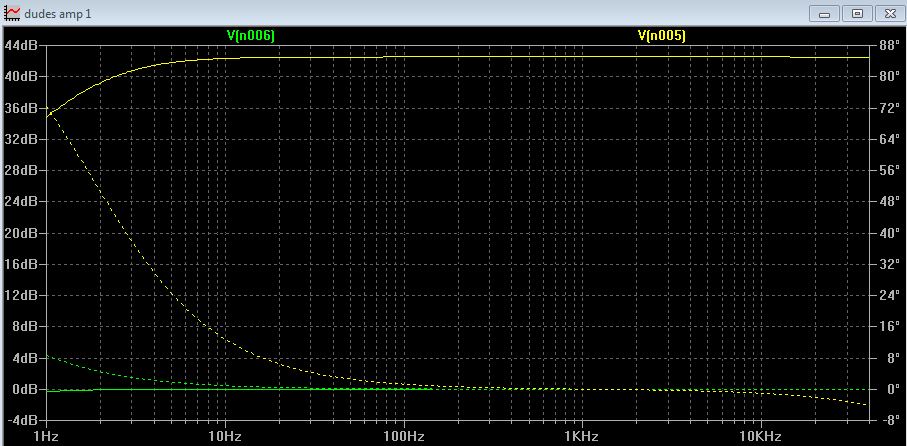

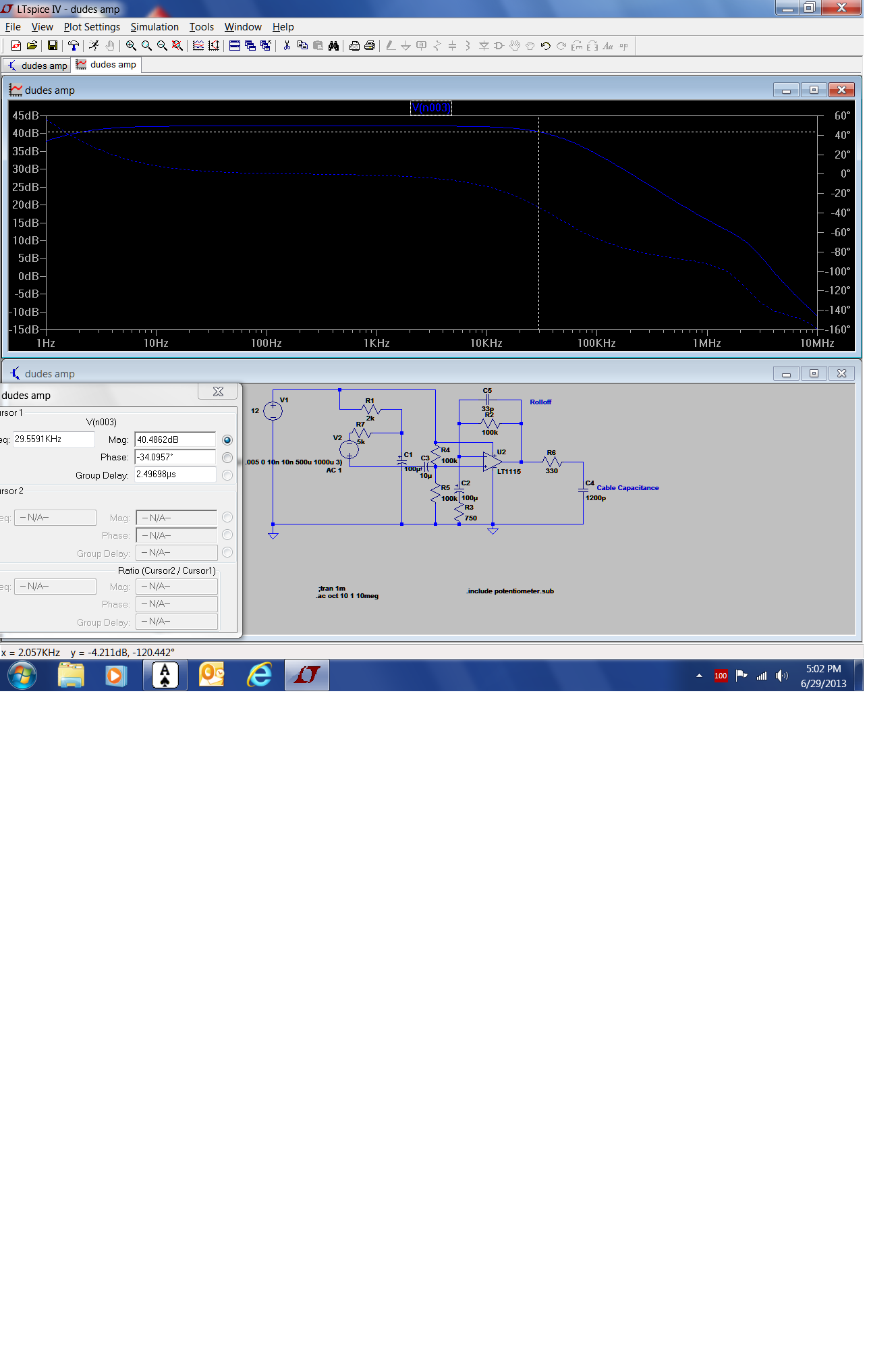

I took your schematic of "dudes amp" and rearranged and it and re numbered the components so it is easier for me to understand. I also substituted a better OPA and increased the caps for better line filtering and better LF response. I am using the caps because I have them on hand and they do wonders for the low end FR (especially C3 on my schematic). I hope increasing them doesn't hurt anything. R6 in the schematic below is a trimmer. And the output will go to Line In on a sound card for speaker measurement. I will not be recording anything but would like the measurements to be as accurate as possible.
Before the cap and OPA changes, the circuit was down 3 dB at 20Hz and at 20K Hz. Now it is almost straight as a string from 20-20K Hz. Indeed, with the better OPA HF goes out to 6.5 meg Hz, makes about a 3 dB rise and then starts to fall. The Q of the HF rolloff is more than 1.
I found a 10pf cap across R6 eliminates the HF peak. Since the pot is variable, so is the effect of the 10pf cap. So when R6 is down to 5K the HF -3 dB point is about 2 meg Hz and with R6 at 100k it is about 130k HZ. If R6 goes significantly below 5k, the hump comes back with a vengeance. Is this hump anything to worry about? I hope that the circuit is OK without the 10 pf cap (fewer parts is better) cause the top end seems to be self limiting anyway.
Your "dudes amp" schematic has no current limiting resistor or cap on the output. And I show it the same way. If I use it that way should I be concerned about my M-Audio Transit audio interface (outboard USB sound card)? In other words, is it safe to use as shown? If not, suggestions?
Well, that is about it except for the pictures. They are attached.

The bigger caps should be fine. I don't think you need the cap between the amp and your sound card but it would not hurt anything either. It would be a good idea to add some resistance to the output of the op amp because of the capacitance of the cable. Also with the new amp you should roll off the bandwidth or it may oscillate. Without it if you look way out on the bode plot you can see 180 degree phase shift and still some gain. So I added a little cap to bring it down to 30 - 40 KHz.
Make sure to keep the output signal away from the + input and maybe add a .1 ufd. decoupling cap from the positive supply to ground right at the op amp. Hope all goes well & yes send pictures!:)

I used 10p where you used 33p. We are on the same wave length. I think the 330 Ω series R is necessary. I am glad you do too. Standard layout and decoupling practice will be followed.
I will be using the LM833N. It is an older audio OPA that while not outstanding compared to newer units is decent. And since I have a few, I will use one of them. It should do fine.

ronv, why did you go inverting on the amp/buffer?
BTW, I have some video driver OPAs (AD827) that were used years ago for audio purposes. They have the capability to drive hundreds of feet of high capacitance cables. Gain bandwidth at 20k is around 60 dB. Might they be useful for the wand or the box? Of course I have the LM833Ns that should do just fine.
This is ultimately what I am striving for:
It should save my back and the mass of cables and ancillary equipment I have used before.
I am looking at your latest circuit in LTS and it is very confusing to me with the inverted second stage. But I will work on it.
Thanks. I'll be back.
With the inverting amp is saves the a cap so is a little better at low frequency. Since the output impedance from the preamp is pretty low it works good.
I would stick with the audio amps they will be less fussy and are made for single supply.
The only thing I would add would be a voltage regulator in front of the preamp and for the amp in the box. I think even 12 volts is pushing the mic so if you can get like an LM7809 regulator it would really be sweet and make the supply very quiet.
10K pot for the box amplifier.
