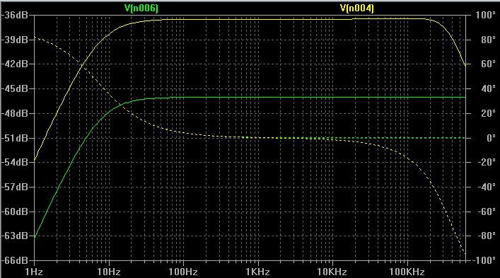

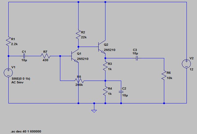

Hi all, I am a noobie here and am looking for help. I am trying to design a BJT Preamp for an ECM cartridge with which to test speakers. I use thru hole components and most of the designs out there require caps that are too big to get into the wand. So I came up with the following design that uses tiny caps and can be put into the wand. Yes it will fit into a 19 mm tube.
I have no training in this area so would like a review of my design and corrections and suggestions. Ideally, it would be great to have a design with reasonably low noise, decent distortion and wide bandwidth (down below 10 Hz). This is not a recording Mic so noise and distortion do not have to be vanishingly low. But lower is better. Also, gain should be such as to be able to get to 1V for line level inputs.
A condition that must be met is that I must use 12V DC to power the Pre.
R6 is a 10k Audio Taper pot in case things get too hot for Line In.

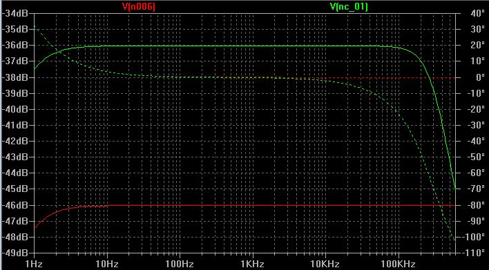

I have attached the schematic and the FR curve From LT Spice. The curve looks good with a low order rolloff and decent transient response on the low end. I would like the bass end extended an octave or so, but that is as good as I could do.
Could you all please take a look and critique what I have done? I do not know if my bias is set right, if the currents are ok for the application or if the gain is proper. I also have no idea about the inherent distortion of the design. Also I would like advice on R6, the Audio Taper Pot. I could go to 50K or 100K. What is the best here?
Any help or suggestions will be warmly appreciated.
Thanks.
Oh, one last thing, I do not know how to model an ECM in LTSpice so I simply used an AC signal source. I am sure that makes a difference, but it is all I could figure out to do.
Oh, one more last thing, I do not mind scraping my design entirely and go to a design with more transistors to get away from those emitter bypass caps. Of course I expect to keep the input and output caps and possibly some interstage signal caps. I was referred from a thread here to a thread about looking at Transistors as voltage controlled devices. There was a circuit there that by using two stages did away with the emitter cap. That is a wonderful idea, but way beyond my abilities. Hell, what I have posted here is way beyond my abilities. That is why I need help!

What is the purpose of C2 ( in transistor version )?
It kills the feedback at higher frequencies and the waveform gets badly distorted.
You can check it in LTSpice, for example at 1000Hz.

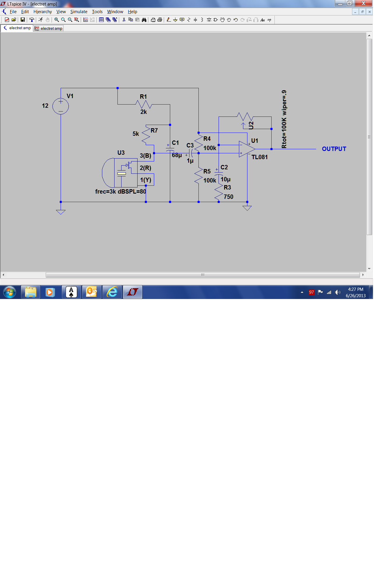

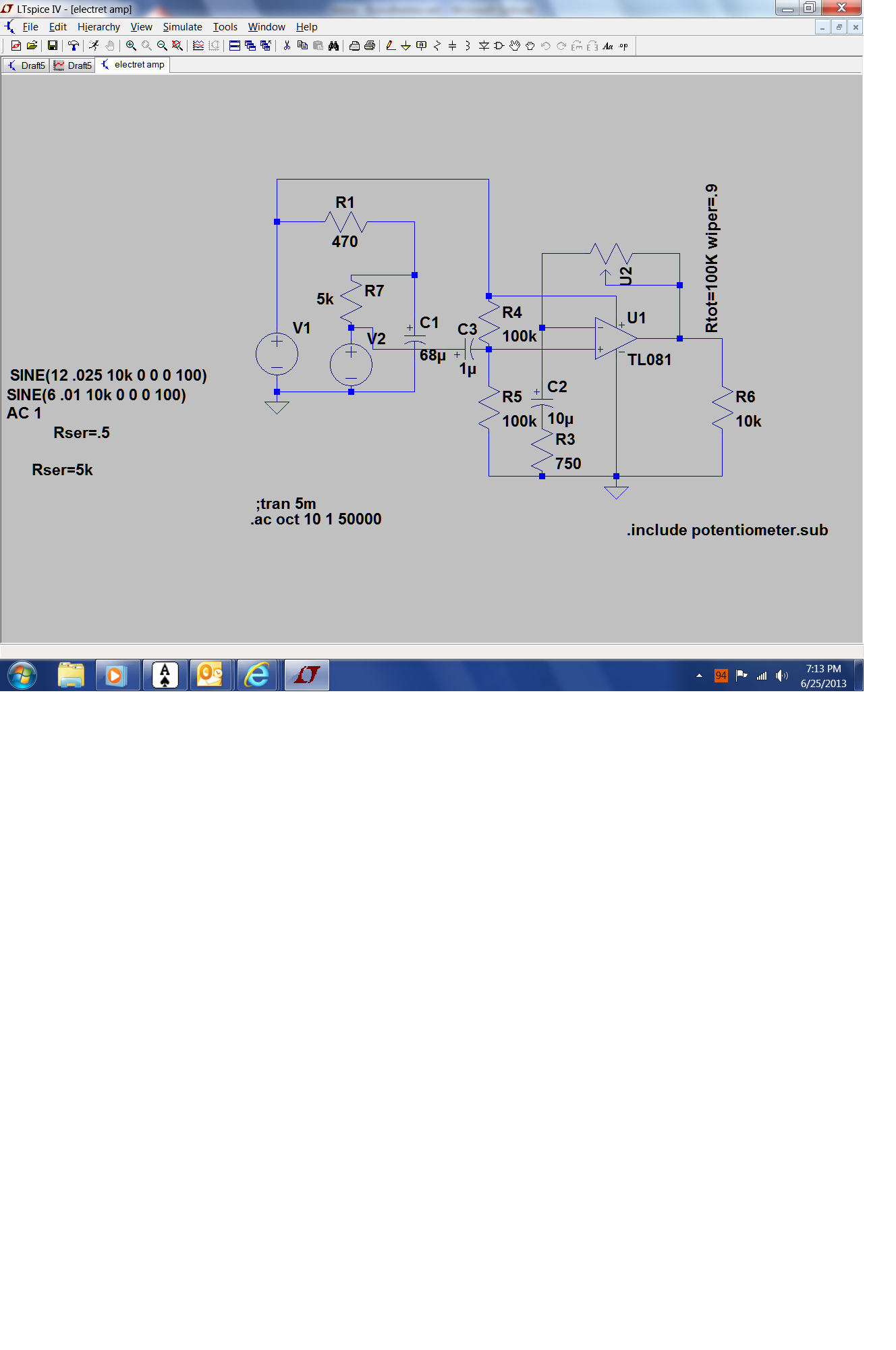

Here is the scoop on the single supply op amp.
V1 is your 12 volt power supply.
C1, R1 is a power filter for the mic. Since with an electret the power supply noise gets passed thru to be amplified it is sometimes needed. If your power supply is real "clean" you can probably make C1 smaller.
R7 is the bias for the mic. The signal is developed across it.
R4 and R5 make what is called a virtual ground so a single supply op amp can be used. It just sets the voltage of the input half way between 12 volts and ground.
U2 is a pot to set the gain.
C2, R3 along with the feedback from the pot sets the gain.
U3 is Eric's microphone model.
Except for C1 the caps can be 10 volts.
I just built one like this for my remote speakers. It was a spaghetti design (no pcb) like yours will be I suspect. I had a little hummmm. So make sure to ground your tube. Hopefully it is metal.

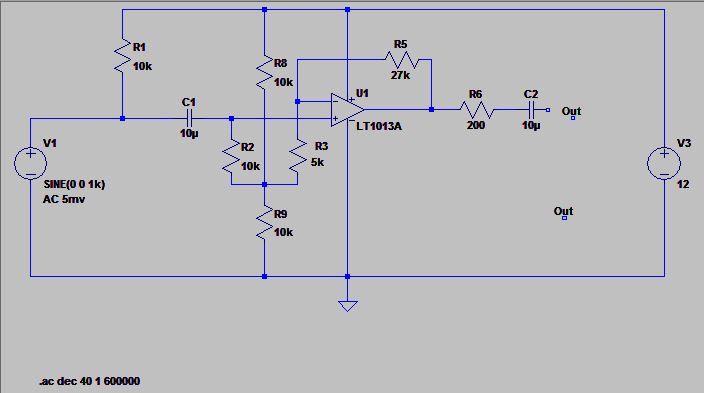

Well here is what I've got.

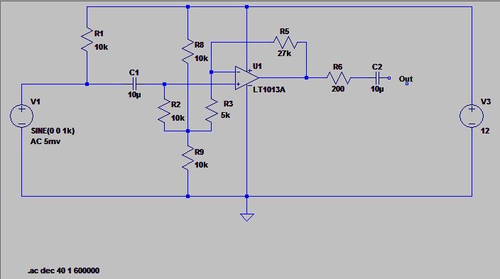

I followed the TI guidelines for single supply operation with OP Amps that are typically used with dual supplies (I have some nice ones). This type of circuit relies on a virtual or synthetic ground for the Op Amp's operation. The supplies to the Op Amp can be fed by a single supply as I show. But all circuitry relating to the operation of the Op Amp must be operated by reference to the virtual or synthetic ground. TI further says that since the supply ground is part of the system, that caps must be placed at input and output of the Op Amp's operations to safely and properly interface the Op Amp's input and output to single supply elements that do not reference the virtual ground. So, all operations within the caps must be referenced to the virtual or synthetic ground and elements outside the caps are referenced to PS ground. I have done that too. Here is the schematic.
The bandwidth of my circuit is a bit better than the SL circuit because I used a bigger input cap. One thing that puzzles me is that I had to crank up the gain on the Op Amp to 20 dB in order to get 10 dB gain from input to output. Anybody know why? Does the virtual ground reduce the input signal? I can't figure it out. But here is the FR of my single supply circuit. Its not shabby and it is 10 dB gain from input to output.
A couple more things. There will be a .1uf ceramic between the Op Amp supply pins. If you know that the circuit output will go to a capacitor input, then I think the output cap can be eliminated. The likelihood is that all circuits that will interface with my setup will have capacitor inputs. The beauty of this circuit is that it is tiny with few caps and no big ones. It will easily fit into my 19 mm D pipe. And yes the pipe is metal and will be properly grounded. Now I must prevent ground loops.
One more thing, given the constraints suggested by TI, I am not sure the circuit provided by ronv will work properly. I have not put it into LTSpice yet (I was too busy with my own) but as I understand the circuit and TI's admonitions, R5 and R3 in ronv's circuit should be connected to virtual ground for single supply use. But in ronv's circuit it they are connected to actual ground. TI says no to that. Does the cap make the difference?
Please review my single supply version and tell me what is wrong with it or how to improve it and maybe tell me what is going on with the gain thing. All suggestions and objections are welcome.

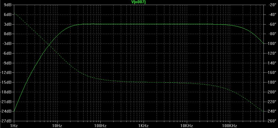

Your final circuit image has only a gain of about 3.
The problem is the OPA feedback resistor value [27k] is divided by the 5K and the three 10K's
in the biassing network. As you may know Gain = Rfeedback/Rin
I have run a test on the electomet microphone model of LTSpice and it matches close enough to the actual plot of a 'real' electomet.
The overlay drawing is not very clear, but you get the idea.
Eric

The 2 supply circuit works, but R3 should be larger. The reason is because the mic has a fairly high impedance. In the drawing shown it is 10K. To see the effects of this you can add 10K to the series resistance in the voltage source so you will loose 1/2 of the amplitude. It also needs a lot more gain if you want to get 1 volt out as the mic only outputs a few millivolts - maybe 5 in normal voice.
In the other circuits.. they just don't work well for several reasons but one is that they have DC gain. So If the input is at say 6 volts the dc will also be amplified. That is the purpose of the cap to ground in my schematic.. The DC gain is now 1 and the AC gain can be over 100. Here is the asc file so you can play with it. You can replace the TL081 with the LT1013 since you probably don't have the TL081 in your library. To run the bandwidth and stuff replace the mic with your voltage source and remove the 5K.
Maybe you could add the link to the TI sheet you are looking at. Maybe I'm missing something.
