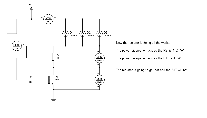

that 3.2V across collector resistance will diss power and become to hot!
I'm loosing the will to live..... Do you know the reason they call it a transistor!!!!

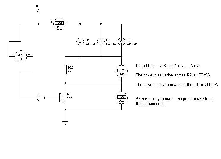

Transfer resistor.... You need to design the BJT to your circuit... If you fully turn on the transistor then there should be nearly 7.2v across your resistor... BUT if you work out your current gain you can partially switch on the BJT to give a smaller voltage across your resistor so the BJT dissipates some of the power...
At the moment ALL of the power is lost in the resistor... Using the BJT share the power loss between them..
Look at these two designs..
OK, using low value Resistance will BJT to diss less power rather than Resistance.
