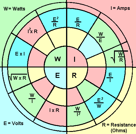

Why did you take it as 5-4? What is 4V. Forward Voltage across diodes wont be 3v ot 2v always. You need to take the resistance of the diode in this case, and not the Vf.
OR!!!! Drop the resistance...
