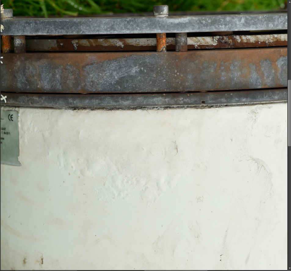

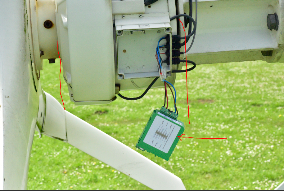

The generator itself is between the red lines, I can take better pics now the shrouds are off and the coupling. They are really heavy coming in around 480Kg each, The green box is part of this 'warner brake' system, i dont think i actually need the brake for what we want to do.

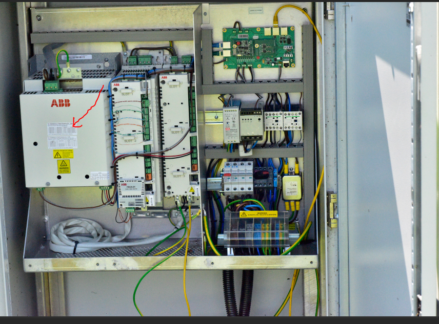

The red arrow shows what i was told was the inverter, a close up dosnt show much so again I can take more pics.
Sorry the rest look corrupted! I will try and take some more. Any thoughts so far? The sticker on the large ABB units talks about a max 0f 500V AC, however in the other panels are large stickers warning 600VDC?

Wind turbines are usually a lot more than just a generator and an inverter. The brakes are there to prevent overspeed. There are also feathering systems to prevent overspeed, but that isn't always enough. Some of the circuitry is to sense and control speed, weathervane position, cooling, phase/grid synchronization, remote controls, network connections, etc. Do you know whether this is a PM or alternator (externally excited field) type turbine?
I doubt that thing you pointed to is a 5.6kw inverter -- it doesn't look nearly big enough, or have any appreciable cooling, or, for that matter any visible busses that could handle 600v at 10+ amps.

The inverter is a grid tie jobby, there are diffo kinds, the simplest just switches the dc direct to the mains connection at the right time, and then does so again but with reverse polarity for the second half of the cycle, they call this modified sine wave, but it is for all intents square wave with dead time.
Better ones use a higher freq switching speed, 4khz is common, and then fabricate a sinewave with Pwm and a lookup table, the Abb one most likely does this.
The little contactors are probably there to drop out if the mains fails, you dont want to shove power back into the grid when theres no amins, some poor old engineer down the substation wouldnt like that if they thought power was off.

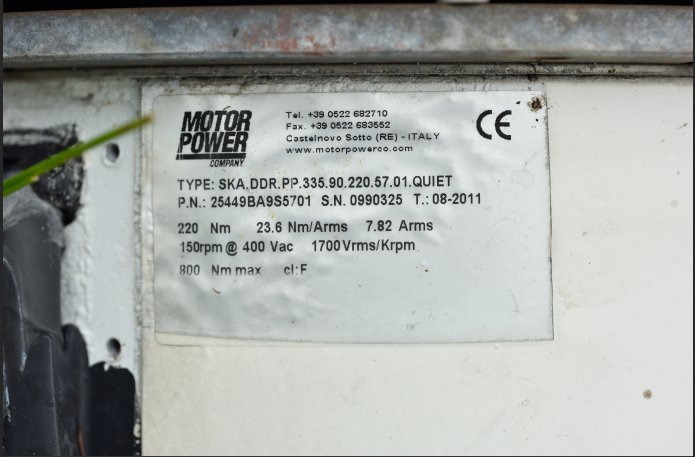

I might have this all wrong, its raining so cant grab a pic yet, the label on the generator and the cable make me think its a alternator. Also mentions alot of figures, one of which says 400VRMS @ 150rm.......which could be good or bad depending, for use i would like 440V at 440 rpm (PTO low speed). But I guess i could gear it down with a sprocket etc. Getting the brakes etc apart is a real *****!! Hex key bending or snapping GRRR
got some pics!!
other pics are too large apparently!! so will mess with them later. the cable is 5 core, two have earth tape wrapped around them but i wouldnt take that as meaning much.
So as i dont want to assume much, but being an optimist, am i correct in assuming the 600VDC label in the panel is rubbish and the generator kicks out AC around the 400V mark depending on RPM??
