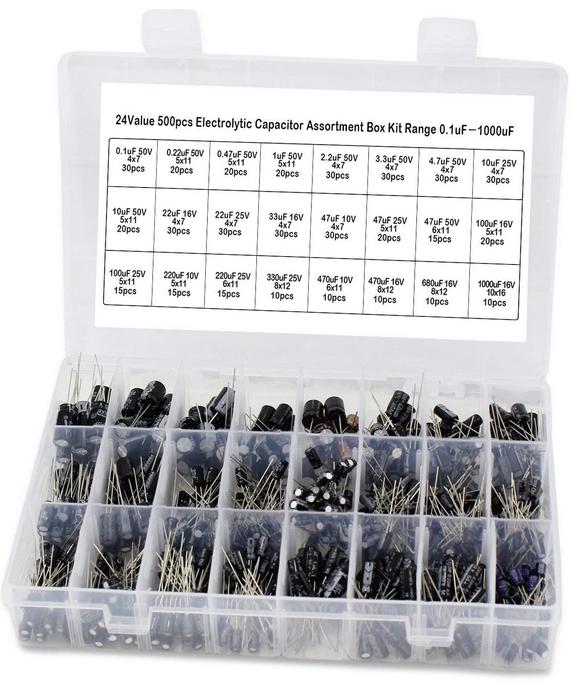

Hi all!! Is there a capacitor kit that has big caps out there? I have a cap kit but small values like the one in the pic. I would like to find a kit with big caps (to repair PS) instead of ordering single units from DigiKey. THANKS!!!

I don't believe so, as it would be too expensive - and you'd waste most of the values anyway.
As PSU's commonly use somewhat unusual values, it's simpler to order the values you need.
It's also absolutely essential that you order high quality ones (I tend to use Panasonic), and low-ESR ones are a good idea if available. The reason the caps failed in the first place is because they are poor quality, no point fitting ones that might be even worse.

The problem with looking for a kit of caps, you can end up with 25 caps that are 1000uF. The physical size of a cap can change quite a bit (height and diameter combinations) to fit the existing board and then you have voltage limits and ESR and...
