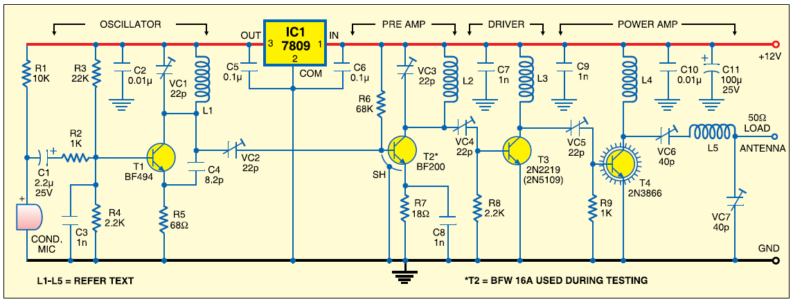

I'm having hard time finding this transistor in my local market,, I want a replacement of this transistor. Alternatively what transistor can be used beside BF200?

According to the datasheet, BF200 is an RF transistor with high fT and very low junction capacitances. If it is used in an RF application, you probably cannot substitute BC547 or 2N2222, or 2N3904, or any other general purpose transistor.

Are you using it in the oscillator or buffer (output) stage?
Anything will work in the oscillator stage and something slightly better is needed if used as an output.
I use a 2N3904 transistor as the oscillator and another 2N3904 transistor as the RF amplifier in my FM transmitter and it works perfectly.

BF494 is in oscillator stage and BF200 is in pre-amplifier stage in transmitter. let me post the schematic....
What you have to do is get a LED Power Meter from Talking Electronics website and put it on the base of the transistor in the pre-amp section and then the collector of the pre-amp stage and see if there is any gain. Remove the other output stages during this test.
