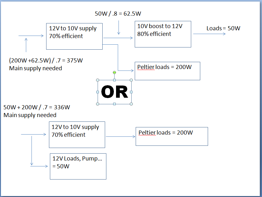

You could use a a switch mode boost off the peltier supply to do the pump.
Regards, Dana.
I'm not familiar with that. Those would boost the voltage and reduce the amperage though. Am I reading that right? I need to step it down, so 12v remains to the fans/water pump, and decrease it to the peltier tiles.
Thank you for your help!
You would take the main supply, which I gather would be set to 10V, and use this part to boost
back to 12V for the water pump etc.. You have to be careful to pick the boost, make sure it
can do it with 10V in to get 12 out. Just look at specs.
It is typically efficient, 80% or better, so overall power saved. You would divide the
power of all 12V loads by .8 and that would be the power you have to add needed for
the 10V supply for peltiers. So if peltiers consume 100W and 12V loads 20 W then you
would need 120W supply. And you would have to take into account its efficiency in
final calculation.
FYI, there are even, for many applications, buck/boost regulators which will handle
wide range inputs, like batteries discharging, etc.. For this design though you just need
boost.
Regards, Dana.
Example
The second example 336W is total energy need from 12 V source. The peltier supply =
200W / .7
