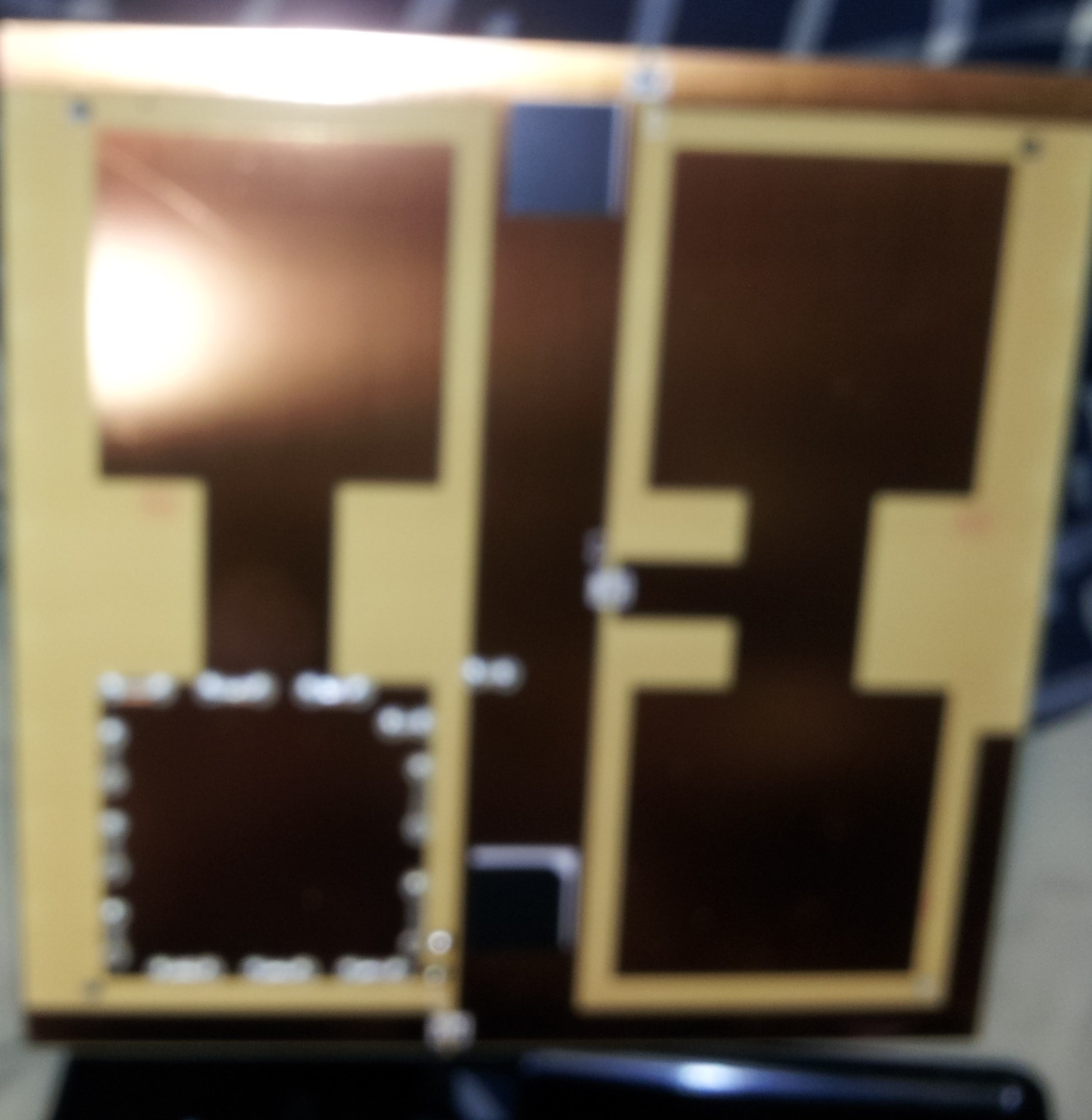

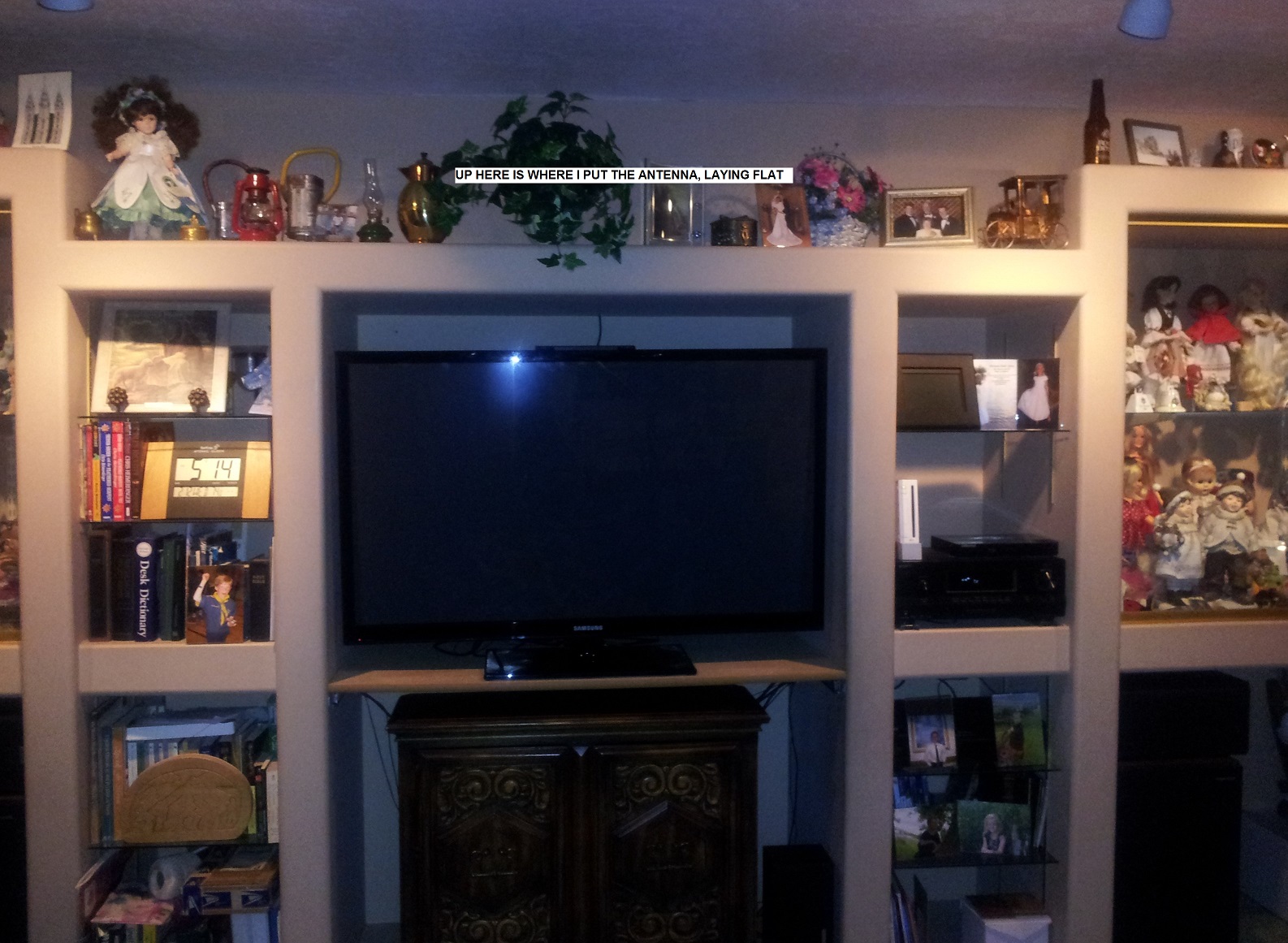

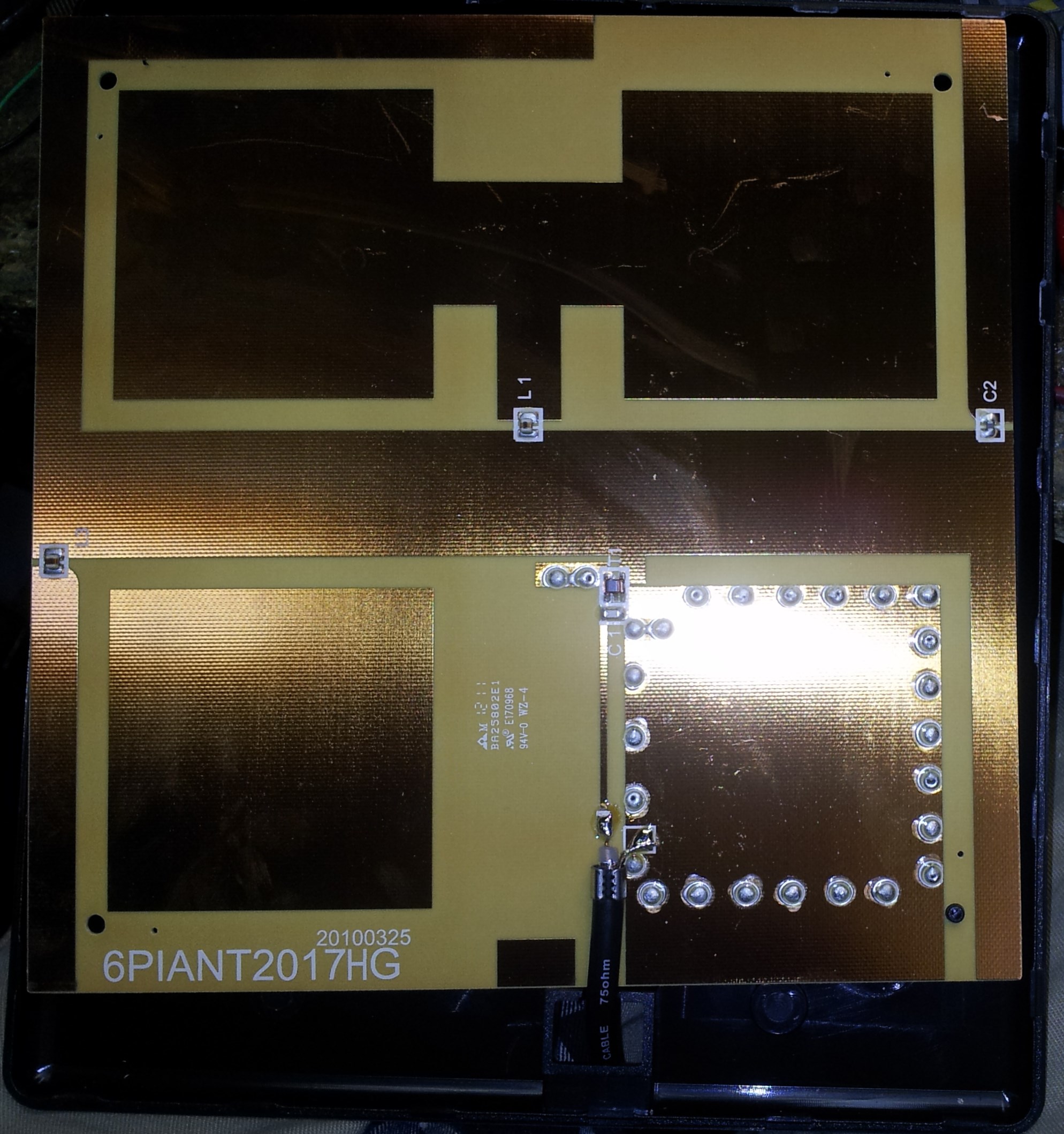

I moved the antenna away from behind the TV, maybe the metal back was hindering it, added the amp that came with it and things seem to be going pretty good now. Here a photo of the insides of the antenna, sort of. Anyone car to explain this antenna?
Yes, it's a load of crap :p
Fit a proper external aerial - a decent size Yagi if you're in a poor area.
These supposed 'fractal' aerials don't sound any use, and 'bow-ties' are low gain but were good for anti-ghosting in the analogue TV days.
