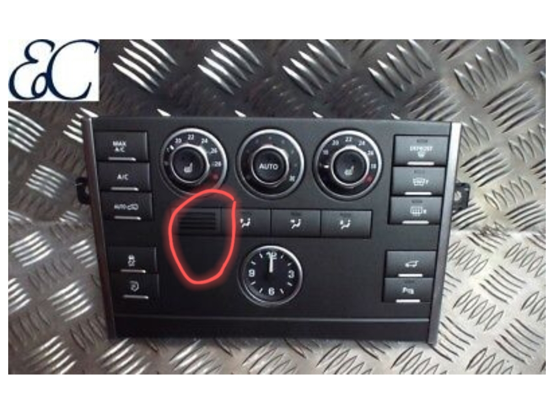

The problem is sensor is not saperate it is in the dash assy inside little vents.
The probe of sensor is gone so i need to put smt.

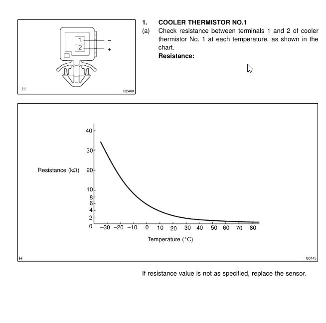

Probably it uses a bead type, but the value could be anything, you need to find its value from the workshop manual for you car .
Try enquring in the car makers users forum for such info.
There are a wide range of thermistor values, which are produced when at 25 deg C.
As you can see my cars thermistor is probably a 2k2 one , but yours could be different, so you might have to try several thermistor values to find the right one, though you might find using a 50k multiturn pot a quicker way to find the right value for the themistor...
