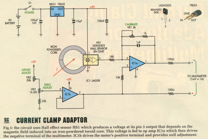

Current sensing isnt that hard unless you need to sense light currents or need super accuracy.
You could try hall effect sensors to start with. Do one device and see how it goes.
If you find you have shorts that go to ground or whatever you might want to think about sensing in both leads of a device. If the current in one lead does not match the current in the other lead, there's an external current path (leakage).

I have a clamp meter gizmo for checking dc currents on automotive & industrial engines, I built a copy of this:

Nope the schem is for a dc clamp meter, there is an offset adjust to zero the reading.
If your installing this permanent I wouldnt make it a clamp, just feed the wire thru, then the zero would be more stable.
ABB make some proper 'dc' current transformers, they work by using an op amp to balance out the magnetic field produced by the conductor, the control voltage being the current to voltage output.

Could you do something similar to detect voltage? Dosnt have to be a meter as such, just something that says yes the cable is live?
It dosnt matter, I have enough stuff I am doing :D, but its kind of interesting.
Detecting 12v dc battery power non contact is tricky, there is hardly any electric field and no ac to pick up capacitively, probably the only way to do that is to have a bleed resistor dump some power so you can pick it up with the current meter, that or just bung a resistor divider and a meter or pic/'duino atod input across the power lines.
Silly suggestion:- A 555 could be configured to generate 100 khz rf, this can be injected to the power lines, lead acids tend to be high impedance to rf, then you can detect the rf on any power lines that are switch on, of course the switches would need to have enough isolation when off for the rf not to be coupled.
Ah no sorry, this was off on a tangent, I was thinking mains voltage. This isnt boat related (my bad), just something else at the back of my mind thats all. Some stuff is best left there trust me :D
Yes you can detect mains voltage, a volt stick type circuit would do that, just a fet and led, plenty examples of those about.
