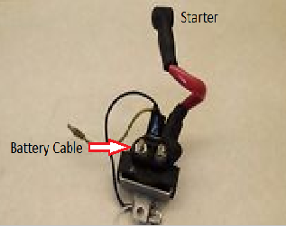

The alternator's output is fed back to the battery through the starter relay to battery cable.
You can measure the alternator's output (at the engine) by checking the voltage level, with the engine running, at the battery connection on the starter relay (using the engine block as your ground).
For that matter, you could also get that value across the battery"s positive and negative terminals (again, engine running).
You should see ≈12.5-14vdc, depending on electrical load and RPM.
The above description is true for most (if not all) outboard engines with starters. And keep in mind that the valued observed does not necessarily indicate that the battery is taking the charge - it only indicates that the alternator is generating charge level voltages.

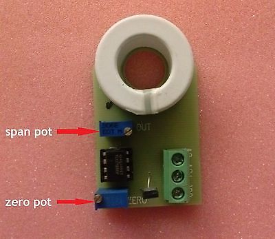

It seems like low-side current sensing could lead to problems. The low connection point of everything (I would say "ground" but I'm not sure what terminology you would use) should be at the same potential.
I thought I had seen some sealed Hall effect DC current sensors on ebay but I must be picturing AC sensors. This picture from ebay sort of shows what I was thinking, but it's not sealed. With a Hall effect sensor, there's also the need to zero out any magnetic fields - I don't know how often you'd have to do this.
I like that approach, or a similar module.
Regardless if you purchase a module or roll your own, for marine use I would strongly advise all the electronic circuits to be completely potted.
Anyways, good luck on your project! It seems like a good challenge and a lot of fun afterwards.

Follow the positive battery cable into the engine. Ordinarily, it will (eventually) terminate at the starter relay, which should look like this:
with the the relay's tab (and one lead) attached to the engine block.
