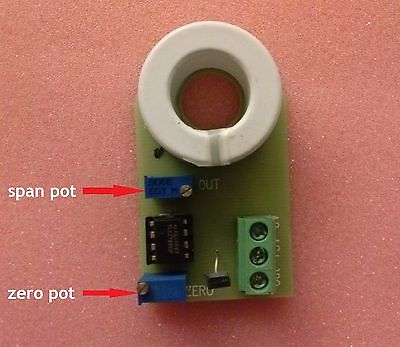

I thought I had seen some sealed Hall effect DC current sensors on ebay but I must be picturing AC sensors. This picture from ebay sort of shows what I was thinking, but it's not sealed. With a Hall effect sensor, there's also the need to zero out any magnetic fields - I don't know how often you'd have to do this.
Thanks for that Jonsea. Is it low side or hide side that cant sense shorts well on the load? I cant remember having just read loads and loads on it :D. I would be cautious with hall sensors on the Boat, space is tight and no guarantee something wouldnt interfere with it.

When growing current sensing from scratch, low side is easier because there are many opamps with a common mode range that includes the negative rail. However, most of the commercial parts are high side. If there is no firm reason *not* to put the measurement shunt in series with the neg, I'd do that. Hall effect sensors do not have this problem, but they are neither precise nor accurate, and drift with temperature. What are your peak charge and discharge currents, and how low a current do you want to detect?

With automotive circuits, low side current measurements are a problem because "ground":is everywhere. If the load shorts to ground, a low side sensor won't see it.
In the app note it lists a couple of disadvantages of low side, The two that concern me is the load can be activate with a low side short. And the inability to detect high current shorts. As its a saltwater environment, and I have already experience a short with a pump in water, this is actually exactly what I want a current monitor for. It isnt always easy to know if something like a pump is shorting out, especially as they are always in some water as they sit at the lowest points.
