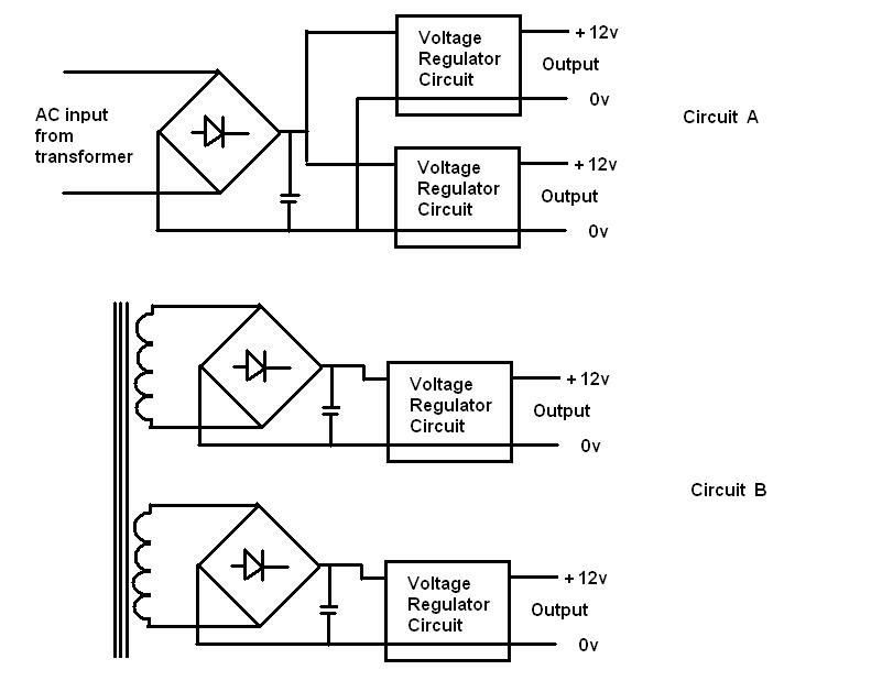

With regard to traps for the beginner, have a look at the attached circuits.
In circuit A there are two voltage regulators driven from one AC supply.
The 0v line of the voltage regulator circuts is common to the inputs and outputs. This is ok if all you want is two 12v supplies with a common 0v line.
In circuit B the two 12v supplies are completely separate and isolated from each other, using separate secondary windings on the transformer.
With this circuit we can also connect the 0v lines together and have two 12v supplies with a common 0v.
We can also connect the +12v of one supply to the 0v of the other supply. In this case we have a + and - 12v supply with a common 0v line. This is often useful when working with op-amps.

Having looked at and thought about the circuit diagrams further, I realise I might as well do the job properly and completely first time.
Would it be best to build a separate bridge rectifier for the voltage regulator circuits or to tap off the variable PSU boards ?
Installing Circuit B is no problem but the connections to achieve 2 x 12 vdc and a common 0v and connecting +12v and 0v together to get +12v and -12v ? Are these best done externally with fly leads or internally with switches ?

I've done some more research into negative voltage particularly from PSU, following up on JimB's suggestion yesterday. Firstly, I understand that connecting a 12vdc to 0vdc of separate outlets would give +12vdc and -12vdc, presumably the joined 'pair' would become 0vdc ? Going from pictures alone, is this often done with a small metal plate attached to the banana terminals on the outside of the enclosure ?

Yes, that's how you connect two supplies to give +/- rails - with the join as 0V.
You do of course need two separate transformers, or a transformer with two entirely separate secondary windings.

The transformer I've got is 250VA 240/24v the outlets are marked 24 - 0 - 24 a total of 3 terminals - is that two entirely separate windings ?
Ah ! OK, well I got two transformers, not a problem. The second transformer has only a single winding, so I could use that and one set of the other transformer and put the 0 - 30v pcb on the other set ? That would work ?
Use the 0-24 winding (ignore the 24-0 one) for one 0-30V PCB, and use the single 24V transformer for the other one.
