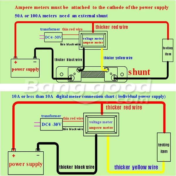

Yes I know you did ! I saw your post some weeks ago when you showed the purchase of both items via a link to the Banggood website and I did a 'good enough for him, good enough for me' type purchase !! So I will have the same problems !
This is on the website, not quite in the same context but does show independent power, may help ? S
and, I've just attached my v/amp meter to 6v then 9v battery, identical decent display from both, must be voltage regulator in line ?
I presume so, just as I presumed it needs an isolated power supply - I have a PSU I built years ago at work, where I had to provide an independent power supply for the digital voltmeter I fitted.
If it's only driving the 7 seg display a 9v battery would last quite a while wouldn't it ?
It's typical for DPM's (Digital Panel Meters) to require an independent supply.
5V was the digital TTL standard. Now your seeing 5, 3.3 and even 1.8 and lastly 0.8V standards.
