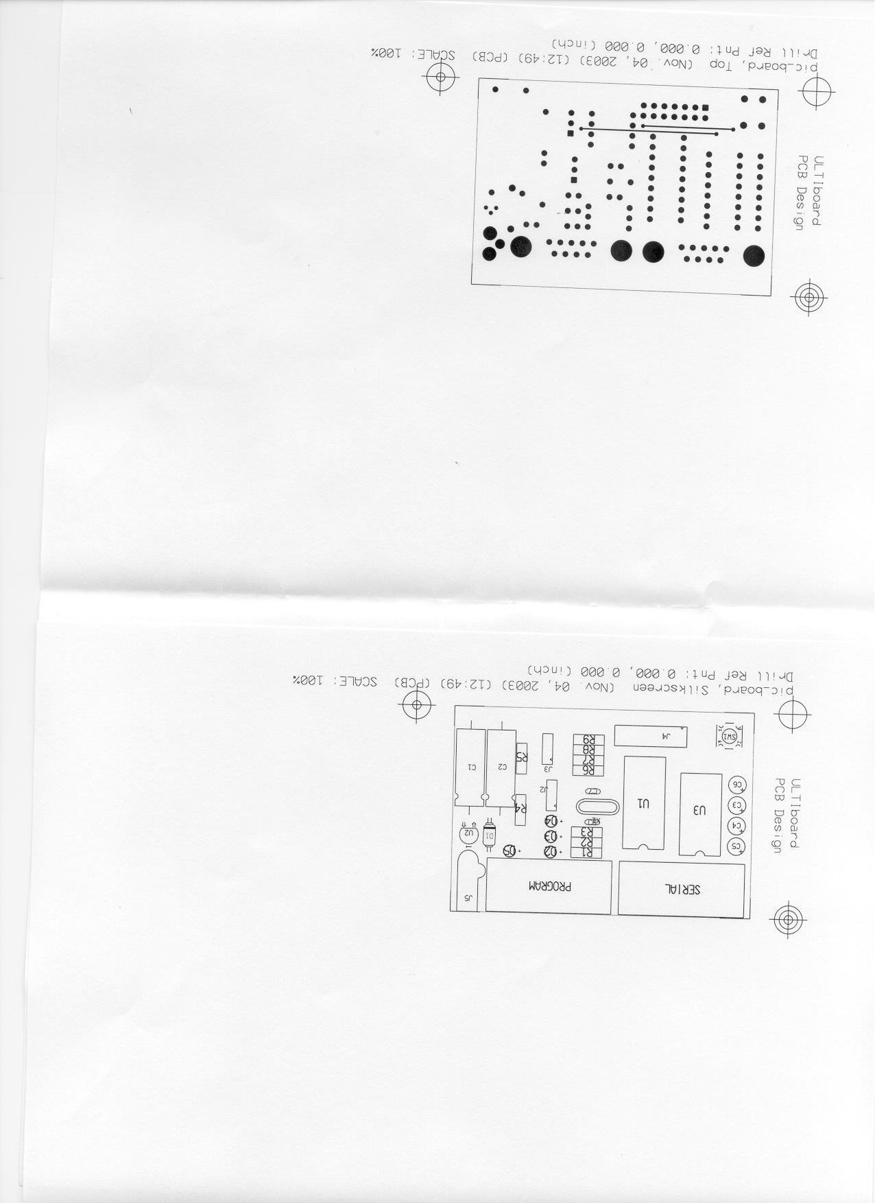

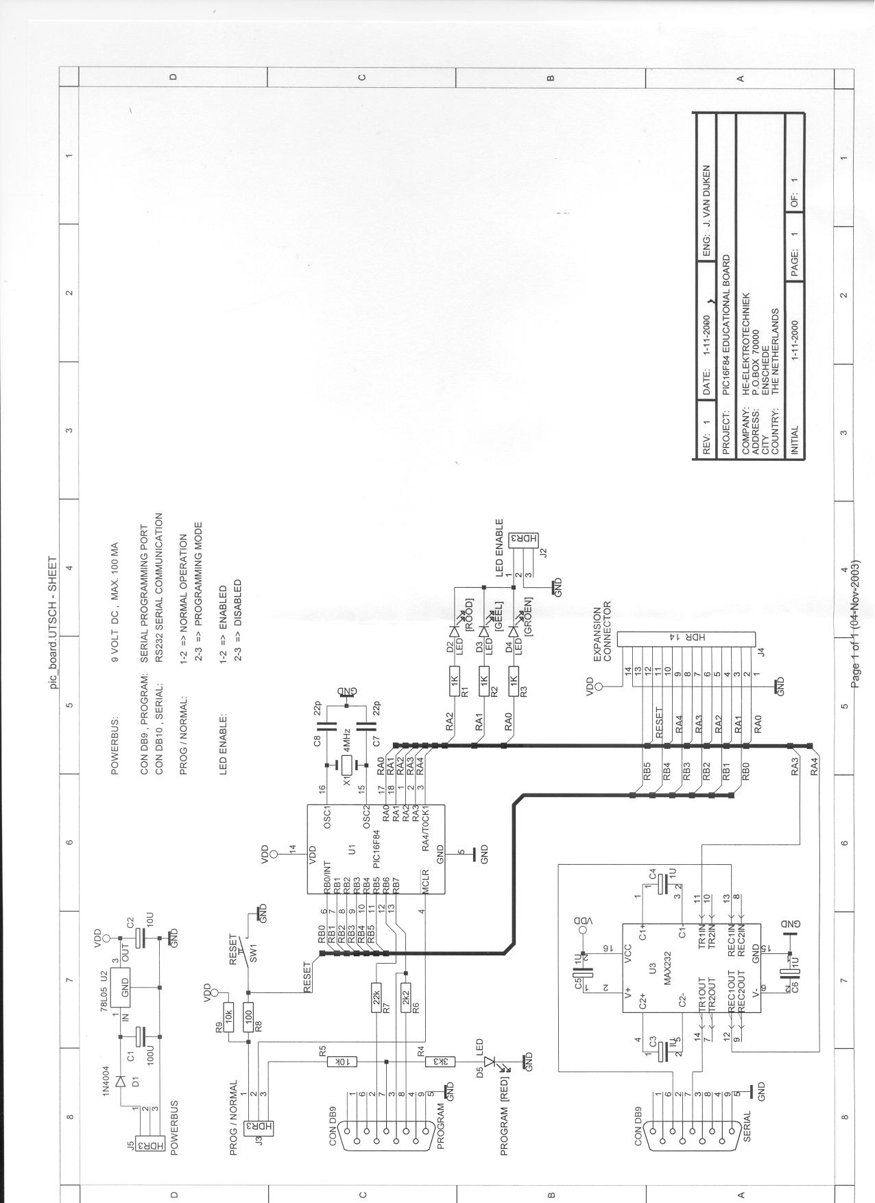

Hey,
I have asked at school for a easy print to use for program and test a PIC. They used a PIC16F84,
I have get one and I have scanned it and I will attach the scan. Meaby I can get the Uliboad and ulicap stuff to but I think you will have some nice when you see this: (PS don`t use the info for provit, only to get started and to try and lurn stuff, thanks)
