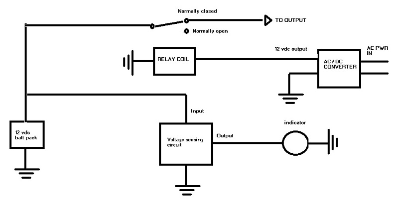

I have a simple 12 volt battery backup device. As long as power is being supplied via an AC / DC adapter, the relay keeps the backup from working.
The circuit is being powered by a 3000 mAH ni-cad battery pack. The sensing part works great and indicates when the battery voltage drops to about 10 vdc (I can change this). What I would like to do is have the sensing circuit switch to charging the batteries. Here is what I understand. If the sensing circuit switches power from the adapter to charge the batteries, then it will now "see" a full 12 volts and stop charging. Then, re-see that the batteries are low and turn the charging back on. An oscillation loop. How do you prevent this?
Look up hysteresis, which any such system should have - however, the battery shouldn't instantly go to 12V when you start charging it, it will gradually increase (which is an indication of it's charge level).
You also need to be careful how you charge the batteries, for both safety reasons and to prolong battery life.
First, I have not done anything with regards to charging. Next, what is hysteresis? Nothing on the web explains this easily to me. I know that the batteries need to charge SLOWLY. The adapter that I was going to use had an output of 1 amp. I read that the batteries needed to be charged at a maximum of 10% of the mAh of the battery. I don't really care how long the charging takes. The adapter I have now is only 50 mA - just enough to pull the relay contacts in. I do realize that this would potentially take days to charge the battery - I don't care. Does anyone else have anything that will help me?
Thank you so very much for your research. This was not sarcastic as I know that this took you time. This explanation was spot on! I understood the concept perfectly as I have experienced this personally. Now, how does this help me with preventing an oscillation loop when I go to getting this battery pack to charge? As far as I still understand, slowly ramping the voltage up to the charging state will STILL cause this to happen. It will happen because the batteries will not charge correctly until the proper voltage is applied across them. Then when that happens the sensing circuit will cease charging. Now that charging has stopped, the same circuit will sense the low level battery and charging will again start by ramping up (as before). I'm sorry but this don't help.

If you have no hysteresis and you set the end of charge detector set to 14.000 volts (For example.) when the battery reaches 14.001 the charger will be switched off. The battery voltage will start to drop. It will quickly drop below 14.000 volts so the charger will switch back on. this sequence will repeat until something is done to stop it. This is oscillation. It would be much better if the charger did not switch back on until the battery voltage dropped to say 11.000 volts. This behavior can be achieved by adding hysteresis to the voltage detection comparator.

I'd say you need two voltage comparators plus a timer, none of which is all that complex or expensive.
One comparator that triggers at the low voltage discharge level and switches the charge system on.
And the second switching at the full charge voltage and enabling the timer.
Once the timer expires, it turns off the charge.
That allows full charge then some trickle charge time, which is pretty essential with NiCd or NiMH batteries, to equalise the cells and maintain them in good condition.
For the simplest practical and moderately fast NiMH "charger" setup, you need a DC power supply a volt or two higher than the full charge voltage of the battery.
You connect that to the battery via a rectifier diode and series [power] resistor.
The resistor value needs calculating so when the battery is at its full charge voltage, the current is just under C/20
That means when the battery is at its minimum voltage, the charge current will be rather higher; the less difference to the power supply at full charge, the greater the initial current increase.
eg. Using a 16V supply: Approx. 0.6V diode voltage so 0.4V across the resistor and 150mA C/20 gives about 2.7 Ohms; I'd try three ohms.
At minimum charge, 10V, that means 5.4V across the resistor and an initial charge of about 1.8A
The resistor would need to be rated at 10W or higher.
The one thing you cannot do is directly use a DC supply with no current limiting, or one lower than the battery full charge voltage. The battery or power supply would be damaged, eventually if not immediately.

A three cell battery is either not 12V, or it is using lithium cells - which need incredibly critical charging, with cell balance control, or they may burst / catch fire!
For info, C/10 is the "14 Hour" charge rate for NiMH or NiCd cells, not the only current allowed.
They can be charged much faster IF they are not overcharged at all; eg. Energiser say C/2 is fine, C/1 should be used with caution - but anything using that current continuously must have intelligent charge termination.
Or they can be charged slower. C/20 is the maximum permitted "long" charge, eg a couple of days, and C/40 can be applied forever to NiMH cells.
Nickel based cells are not harmed by a permanent low current trickle, it can improve their condition.
(And none of that applies to lithium - you cannot overcharge them in the slightest without making them unstable).
If you want to independently check charging requirements for any type of battery / cell, have a look at the "Battery University" site:
