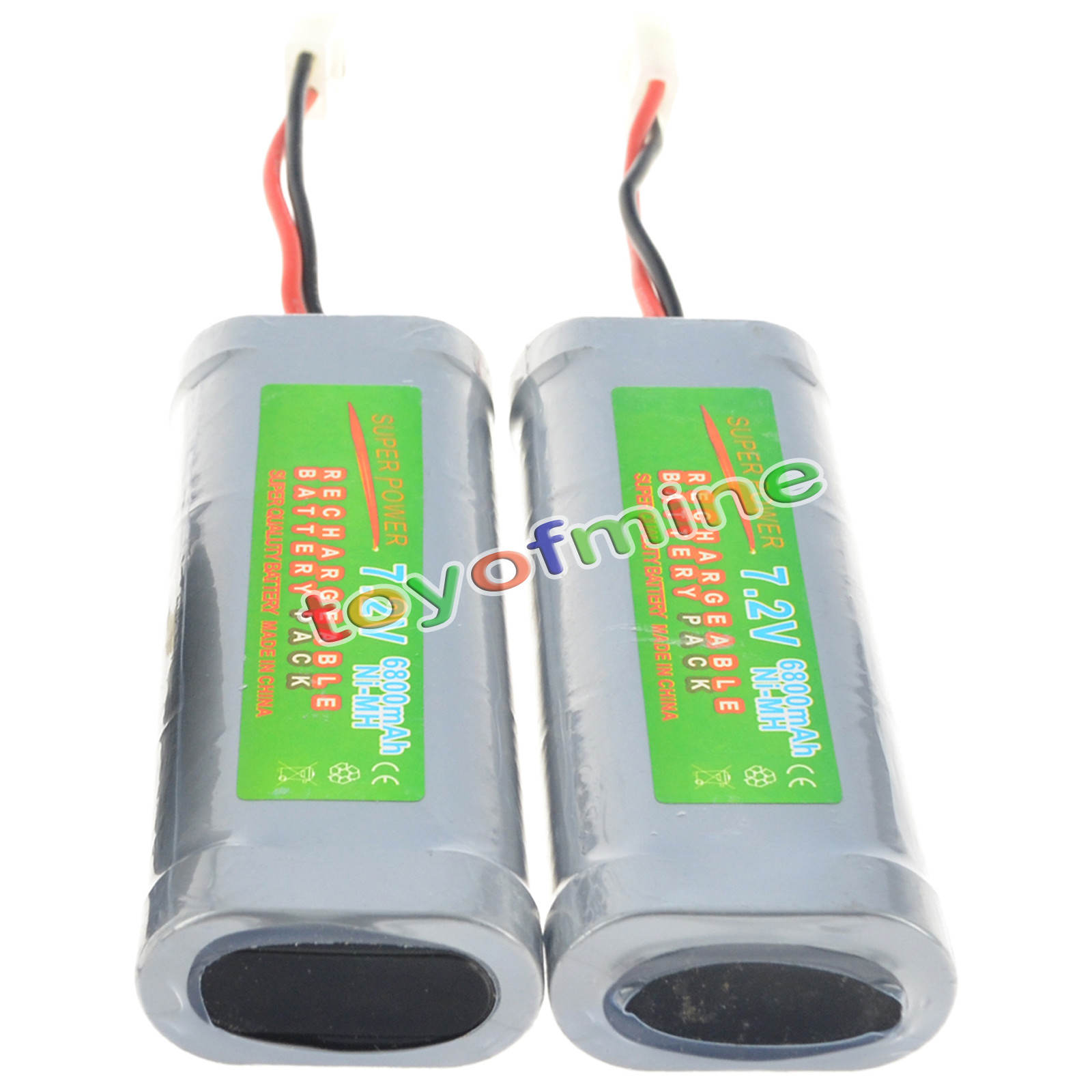

I recently bought a bunch of 7.2V RC car batteries from Ebay and upon arrival, they were pretty much fully charged. Now I used up a couple of them (their voltage now is around 4V) but I want to recharge them
Both are Ni-MH and one is 6800mAH and the other is 4000mAH.
The 6800mAH looks like one of these:
And the 4000mAH ones look like this:
For each battery order, I also received the same charger as the one shown above this text.

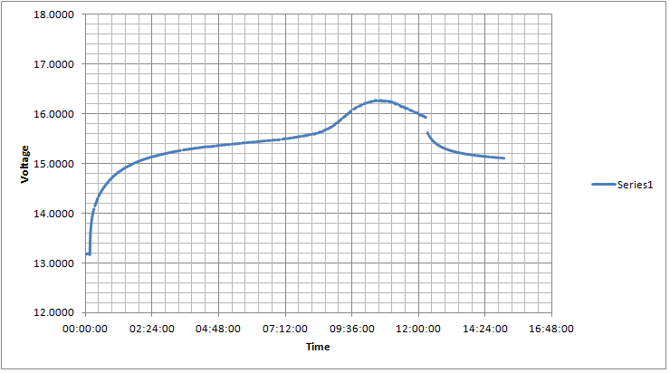

NiMH cells have a very characteristic "hump" at the end of the charging cycle.
The terminal voltage rises and then falls.
When the voltage starts to fall, the charging cycle is complete, if you keep on charging after the hump, the cells will get hot.
During the main part of the charging cycle where the voltage is rising, the cells remain cool.
If you want to ensure that your battery is fully charged, measure the voltage and look for the voltage falling.
Here is a recording which I made of an 11 cell battery pack which I made as I was developing a charger for it.
A PIC detects the falling voltage and switches from full charge rate to trickle charge rate.
The cells in the pack are F size and cost me a fortune!
The gap in the trace where the charger switched to trickle mode, is due to the data logger having a brain fart.
