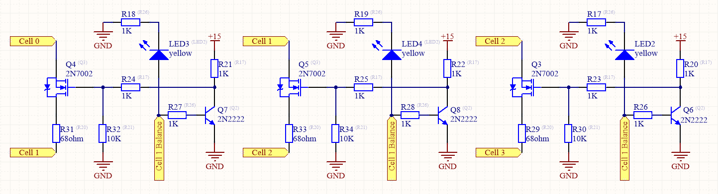

Q1 mosfet is used for charging... I will measure battery voltage, and with PWM turn on Q1 depending on battery voltage. For example if battery voltage is 11V, Q1 will be on 80% duty cylcle (12V) and charging current will be around 1A
I forgot about that Vgs voltage, and i tested on breadbord only for the first cell.
So, now it is ok? I switch every 2N7002 N-CH mosfet with 15V through NPN transistors. So Vgs voltages are 15V for Q4, cca 11V for Q5 and cca 7V for Q3. That should work now? :)
I still think you need charge-current-limiting, as a safety feature in case the PWM fails. Exploding batteries are not a pretty sight :eek:.
When Q6/7/8 turn on, Q3/4/5 turn off.
What you are doing is dangerous, and really you should make all the necessary precautions and make sure they work at all times.
First you need to limit the charging to some value, and that means not using PWM, beacus the current peaks must not exceed the limit, and you can´t really achieve that with plain PWM.
Second and maybe more important, you need to limit the voltage on each cell separately to 4.25V or less. This means that the bypass path around the cell must be able to pass ALL the charging current and limit the cell´s voltage at the same time.
Li-pol batteries store huge amounts of energy, and I suggest you treat them with respect they deserve or face the consequences.
Would you recommend LM317 for current limiting?
For the voltage limiting, i thing software would do it just fine, because i measure every cell voltage and stop charging when it gets near 4.20V for any of the cells.
Alec_t, are you sure about turning Q's on and off? I think when Q6/Q7/Q8 have Vbe 5V they turn on Q3/Q4/Q5 with Vgs > 5V (7V, 11V, 15V). I need to be sure that nothing but uC (from its own power supply) can turn any mosfet ON
Because of slight cell capacity differences, that will likely result in two of the cells (of a 3-cell battery) not being fully charged.
No, they don't. E.g, when Q7 is on, the gate of Q4 is close to 0V, so Q4 (which is an N-MOSFET) is off.
If cells arent perfectly charged, and by perfectly charged i mean 100% charged, but 95% or something like that, i dont mind. I just want to make simple 3S charger for my electric scooter..
Yep, you are right about transistors then. Maybe i should use 2N7002 N-CH mosfet insted of 2N2222 NPN transistor? As i said, i just want to be completely sure that 68ohm resistor arent balancing cells when i uC doesnt wants to
That won't change the switching function. An N-FET and NPN both turn on with a positive control signal.

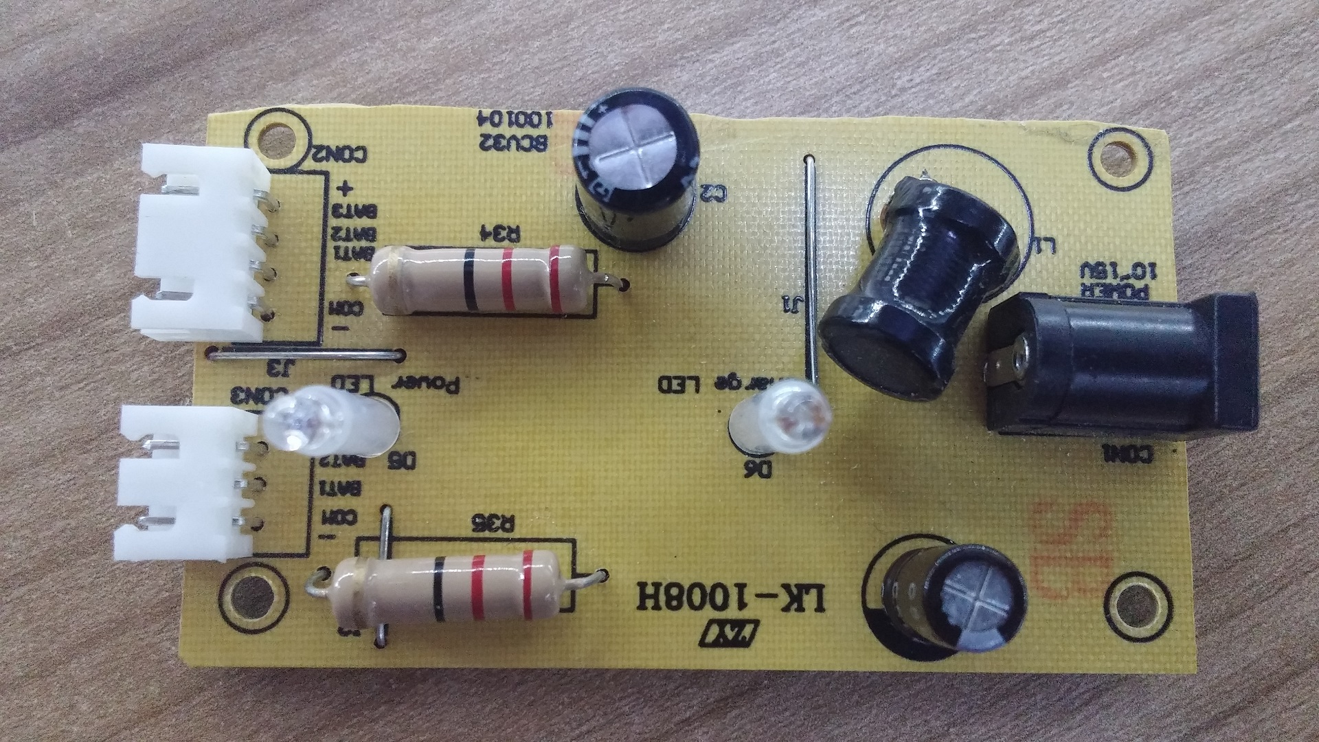

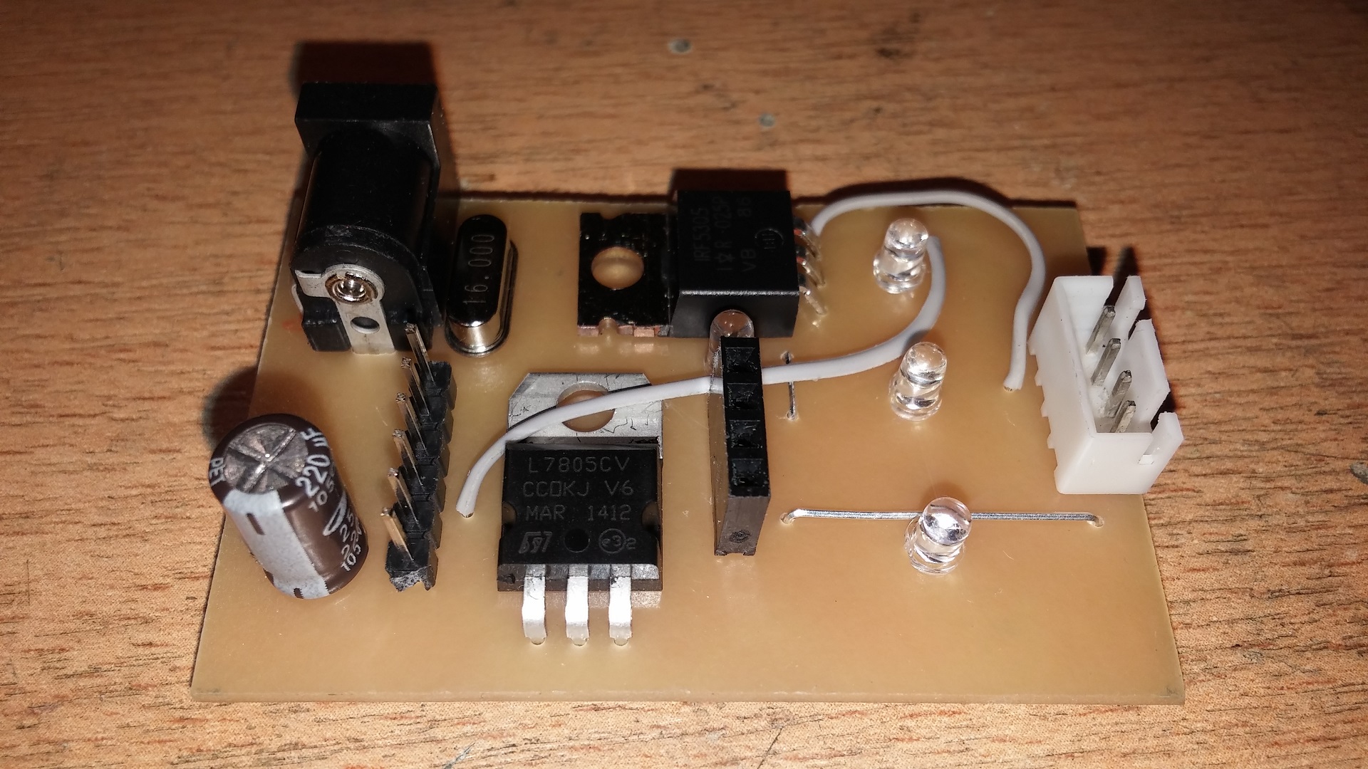

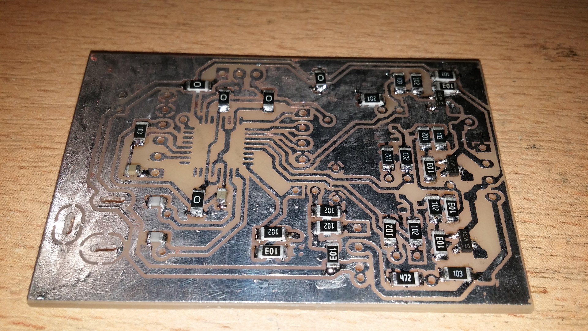

PS. I included a few photos: 2 of my last board (i made it yesterday, programmed it today and its now balancing my battery), and the charger board i want to replace (https://www.hobbyking.com/hobbyking/store/__7637__Turnigy_12v_2_3S_Basic_Balance_Charger.html)
