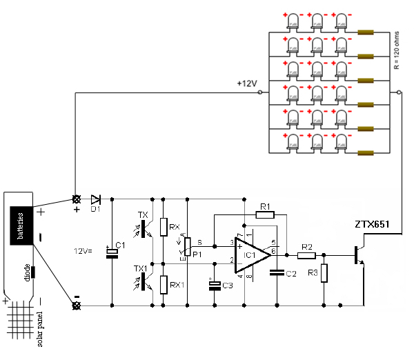

Like this image.

Wow, thanks Eric, thats awesome.
So that new Transistor to replace the relay will make it more efficient, but thats not for a timer is it?
As Nigel points out, the existing transistor is rated at 1amp collector current, so it will do the job, dont need the ZTX.
For the timer I would suggest a HEF4060 with an RC osc [0.5sec/1sec], as a starting point.
so same as your diagram that you did for me, just with the existing tranny ?

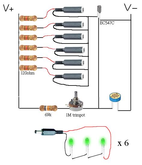

Well the Relay is Gone.. In fact the whole damn twilight kit is gone -
This is what I have now (see pic)
A Friend of mine has just told me there is a chance that 12v Will not run this circuit, can someone confirm or deny this please.... ?
hi David,
Where did this 'budget' circuit come from.?:)
The plastic C547 is not upto the job, especially as the circuit has no hysteresis.
Why does your friend think it wont work from 12V.?
Your image shows GREEN leds.?

HI eric, Im using 10 1.2 AA batts for the power supply.
the transistor seems to work with just one set of LEDs plugged in, are you saying that as I add more, it will start to fail?
What is hysterisis?
(and yes, green superbirght leds (3.3v 20ma)
What is hysterisis?
hi David,
According to the data 'agu' and I have, the BC547 rated at only 100mA collector current.
So 6 chains of 20mA = 120mA.
The other point is, now you have removed the 'fast' switching action of the previous circuit, the led's could be 'half' ON, so the dissipation in the transistor could exceed its maximum rating.

Any npn 500mA would be OK, I use the ZTX451 or 651 1amp series.
as for the 'half on' issue, I have noticed this - depending on how dark it is will change the brightness of the LED's - thats OK with a bigger transistor though right?
The transistor should be OK.
Now Im still stuck with not getting enough juice out of the sun to fully recharge the batteries during one day - And if I do get a bigger solar panel, I have to solve the over charging issue :(
For the over charging, look at a 'shunt' regulator.
