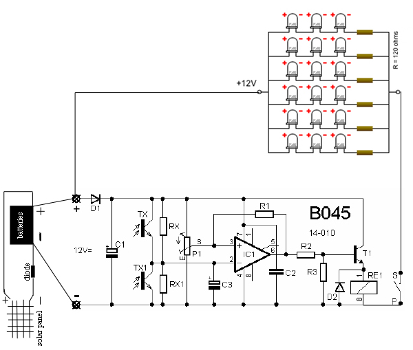

Ok, been reading lots and learning lots...
Here's what Im going with after all my posts and dumb questions - can someone take a look and tell me if this is the realm of correctness (or even the realm of possibility):
- 18 leds (20mA each, 3.2 volts each, split in to banks of 3 leds with the correct resistor to ensure each only gets its 20mA)
- turning on at night with my twilight switch kit
- Running all night and trickle recharging during the day
- Building my own simple solar charger to charge a bank of 10 AA nimh batteries in series (2000mAh or 2500mAh)
As for the the solar panel:
- Jaycar has a large-ish 12 volt panel that produces 250mA (perfect for the 2500mAh AA's)
- Or Dicksmith have a much smaller 2 volt panel that produces 200mA (I would need 6 panels in series, but would suit the 2000mah AA's perfectly)
*Both solar panel options cost about the same and would mean that I would not need to worry about 'current limiters' because at full sunlight, each option would produce the recommended 10% current for the batteries. And according to my reading if you keep them at 10% percent, overcharging is not so much of an issue (nothing a new pack of batts wont fix if its wrong)
Does all that sound about right to everybody - no major misconceptions that will get me blown up or burn my pergola down?
Looking forward to feedback
Thats OK.
Thats OK
Depends on the Sunlight.. but no hazard.
A little complicated, but possible.
I go for this version 20% more ummph.
Sounds OK to me.
Sounds OK, always have a suitable fuse in the battery circuit.
Looks OK.
Whats the resistance of the relay and the type of transistor that drives it.
Strange question, but as an earlier respondant pointed out it could be possible to drive LED's with the transistor instead of the relay, would save power, better endurance.
Looks OK.
Umm.... he's all that I know about it:
BV1719
6V
106 DM
Its blue :)
I did try a really simple LDR circuit earlier in the game, got it to work with light but when I switched it round to be a dark sensor, it would not work. Happy to try again, but would love for someone to tell me what I need with regards to my specific requirements and give me the exact, trimpot, resistor, transisitor values I need....
The relay in the Twi-light kit wastes a lot of current. The relay can be replaced by a transistor that will not waste current.
I don't know the total amount of sun per day at your location. The solar panel produces its rated output only at noon in the Sahara desert so its output will be much less at your location. Before noon and after noon the sun is less intense and at the wrong angle for the solar panel which reduces the output.
If you use a 250mA solar panel and its average output is only 50mA for 10 hours then your 2500mAh cells will be only partially charged.
I think you need a much more powerful solar panel and a current regulating circuit.

I cant get a fix on that relay number.???
Question, why do you want the light to stay ON allnight, rather than say, from dusk until bedtime..?:)
If he does live in Melbourne as someone suggested in an previous post, then he would be at the same same latitude as the Sahara merely on the southern side. Any further north in Australia will simply allow more power to be produced.
I looked on google Earth and found that the Sahara Desert is pretty far from the equator. Melbourne is much farther, about the same latatude as the south of Spain and the south of Greece except in the other hemisphere.
