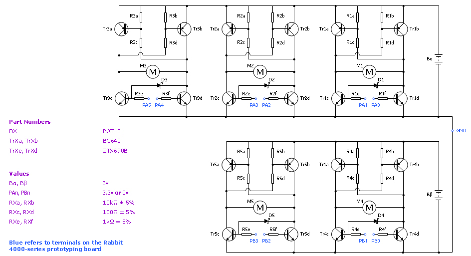

Waiting for my components to be despatched, but in the meantime I've created what should now be the final schematic (attached) :)
Now I just need to work out a PCB layout. If anyone spots any problems with the schematic please let me know :)

Have you ordered the resistors?
The junk box I'm giving you has 100s of 10k resistors in it, maybe some 100R and 1k resistors too, I'll check.
