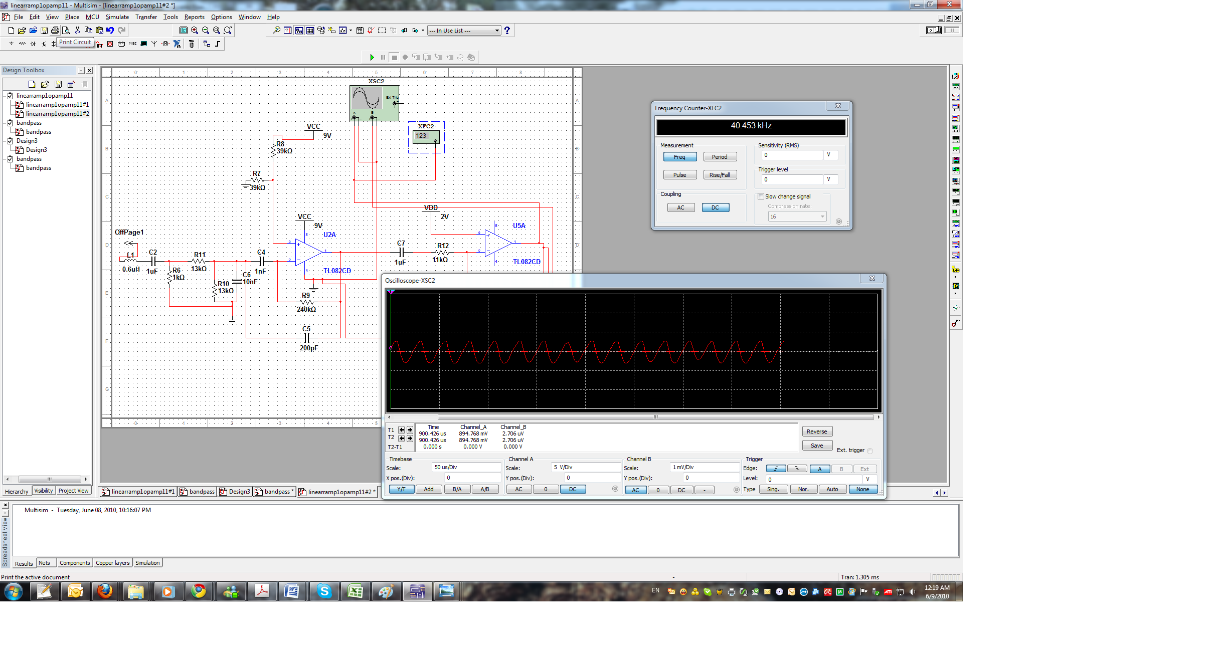

Hi MrAl,

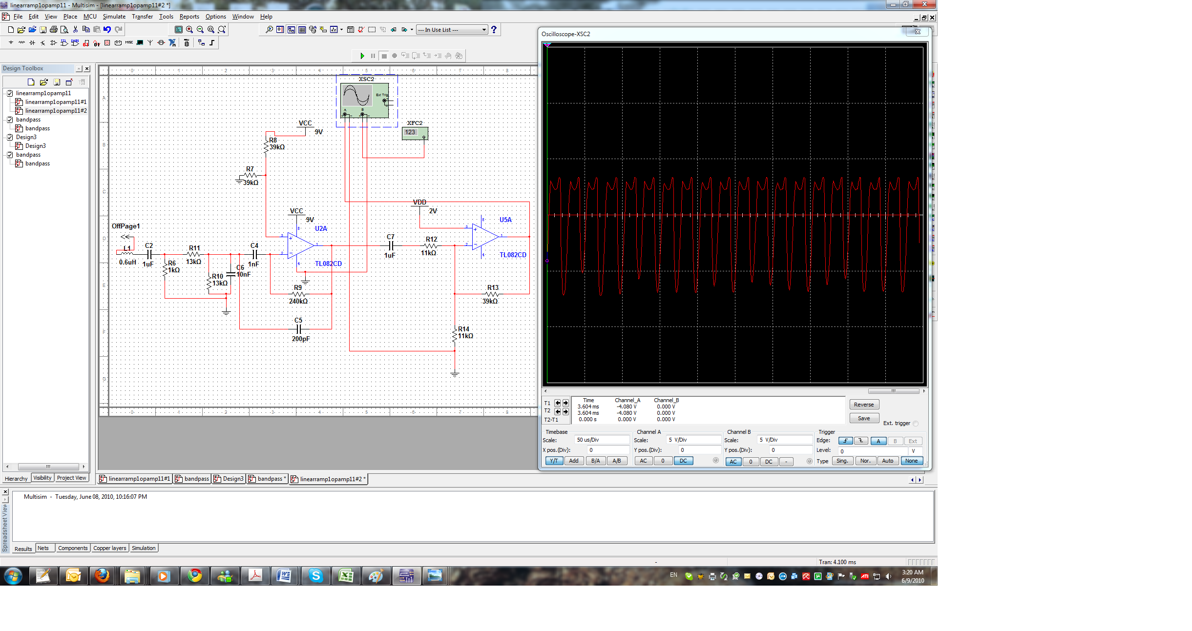

I've changed the filter, eliminated the clipping, and removed the offset (please review the image I've attached). I'm trying to get to about Vp-p~15v, but when I've tried to use an inverting opamp circuit I did get the desired voltage but it chopped at the top. So, now I'm trying to design a some gain loop....
What other problems where you referring to?

I was talking about the problem with the LM358 slew rate. If you have now changed op amps, that's not a problem anymore so we can move on.
The center frequency with the LM358 would be around 40kHz, which is what you want, but when you move to a higher frequency amp the center frequency with your original values would have been more like 64kHz, which is too high for what you want. In any case though, here is a formula for the center frequency for that circuit topology:
Fo=sqrt(R10+R11)/(2*pi*sqrt(C4*C5*R11*R10*R9))
so you can adjust accordingly to get close to 40kHz.
You'll note that the new values you chose for the resistors and capacitors puts your center frequency at around 9kHz, which is not good if you want 40kHz. You'll have to change that.
What kind of bandwidth are you looking for? Originally you had about 6.6kHz with the center frequency of 64kHz.
What usually limits the sharpness of these kinds of filters is the component variations. If you make it too sharp the center frequency sensitivity with component variation means the filter drifts off frequency and then doesnt work well at all because the bandwidth is too narrow. That means there is a tradeoff between sharpness and type of components used. Silver mica caps are pretty good and of course at least 1 percent resistors.
Also, im not sure if you are using a +9v supply but if so you can not get a 15v peak signal out of the op amp with only 9v.
For another thing, you changed the inductor and capacitor on the input but you did not tune it near 40kHz again. It's closer to 200kHz, which is too high.

I really appreciate the help. I'm using the TL082 now which is much much better than the 358. At the moment I have two problems:
1. I decided to do a "wideband" bandpass filter just to convert the sawtooth in the transmitter end, and in the receiver end I'm going to need a really sharp bandpass filter. Both filters should be centered at 40kHz, while the second one should have a band of 2kHz (i.e. 39-41kHz). I didnt decide how to do the second one yet. How wide would you recommend it to be?
2. Since this wave is going to the transmitter I want to amplify it to be around 14-16 Vp-p, but everytime I try to do an inverting opamp circuit it chops off the top of the wave (I'll add a picture in a few minutes). Do you happen to know what may cause it?
I'm using +-9V, not only +9v, so getting a Vp-p above 10v should be possible am I correct?
Thank you again for your help.
Never mind the third question, I did some reading about it and found out that it's common to amplify and then filter.

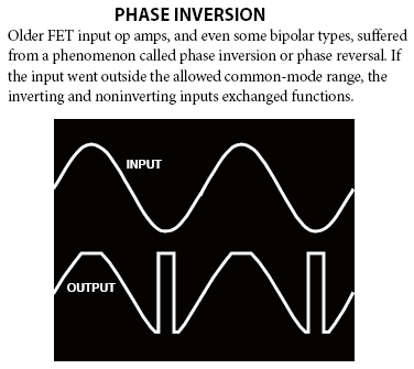

Your circuit does not have a plus and minus 9v supply. It has only a single +9V supply.
The first opamp is correctly biased at half the supply (+4.5V) but the second opamp is biased too low at only +2.0V.
The TL082 has an allowed common-mode input range of about 3V above ground in your circuit so its inputs do not work when they are only +2V.
The TL082 has a problem called "Phase Inversion" where the output suddenly goes positive when an input voltage is too low.
So try biasing the input of the second opamp at +4.5V.
I don't know if your simulation software knows about these details.
None of the Multiple-Feedback-Bandpass Filters I have seen use capacitor C6 that you have in your filter. Remove it.
The wideband input of the filter (to R11) must be fed from a very low impedance like the output of an opamp so your LC filter is probably messing up your opamp filter.

Here is a picture of the chopped waveform.

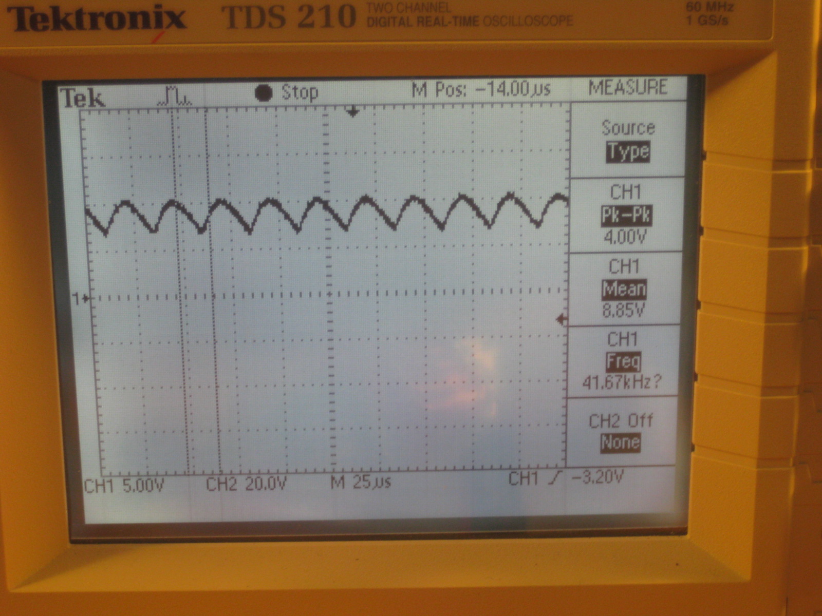

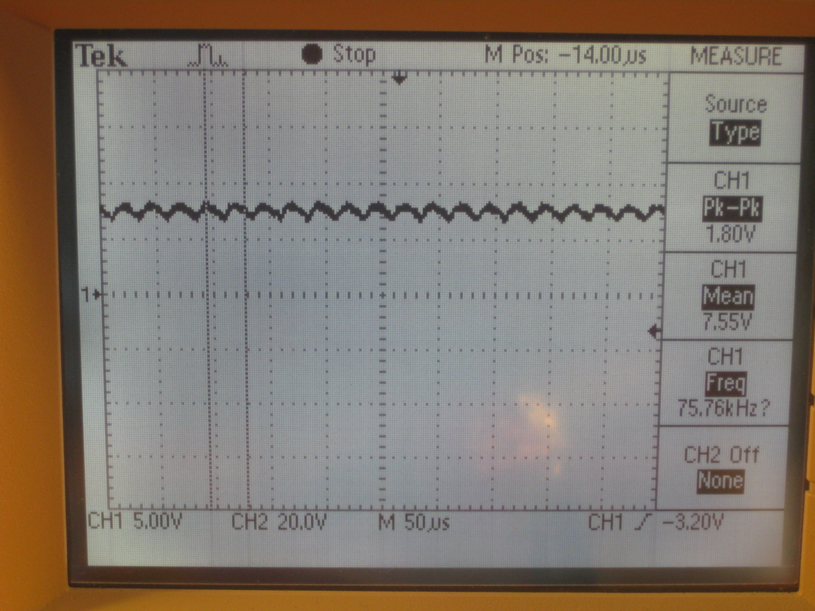

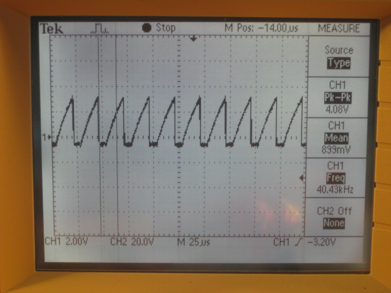

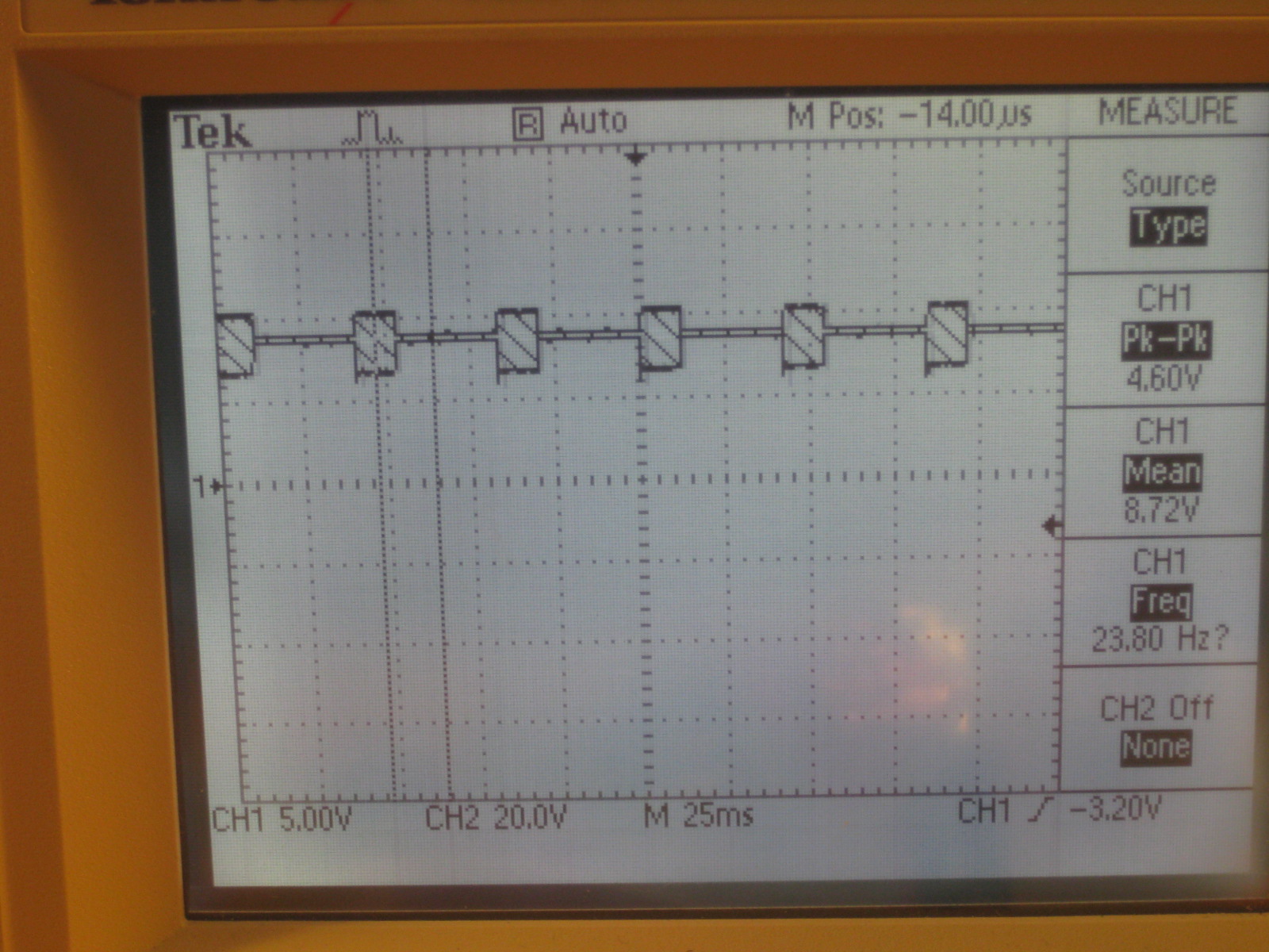

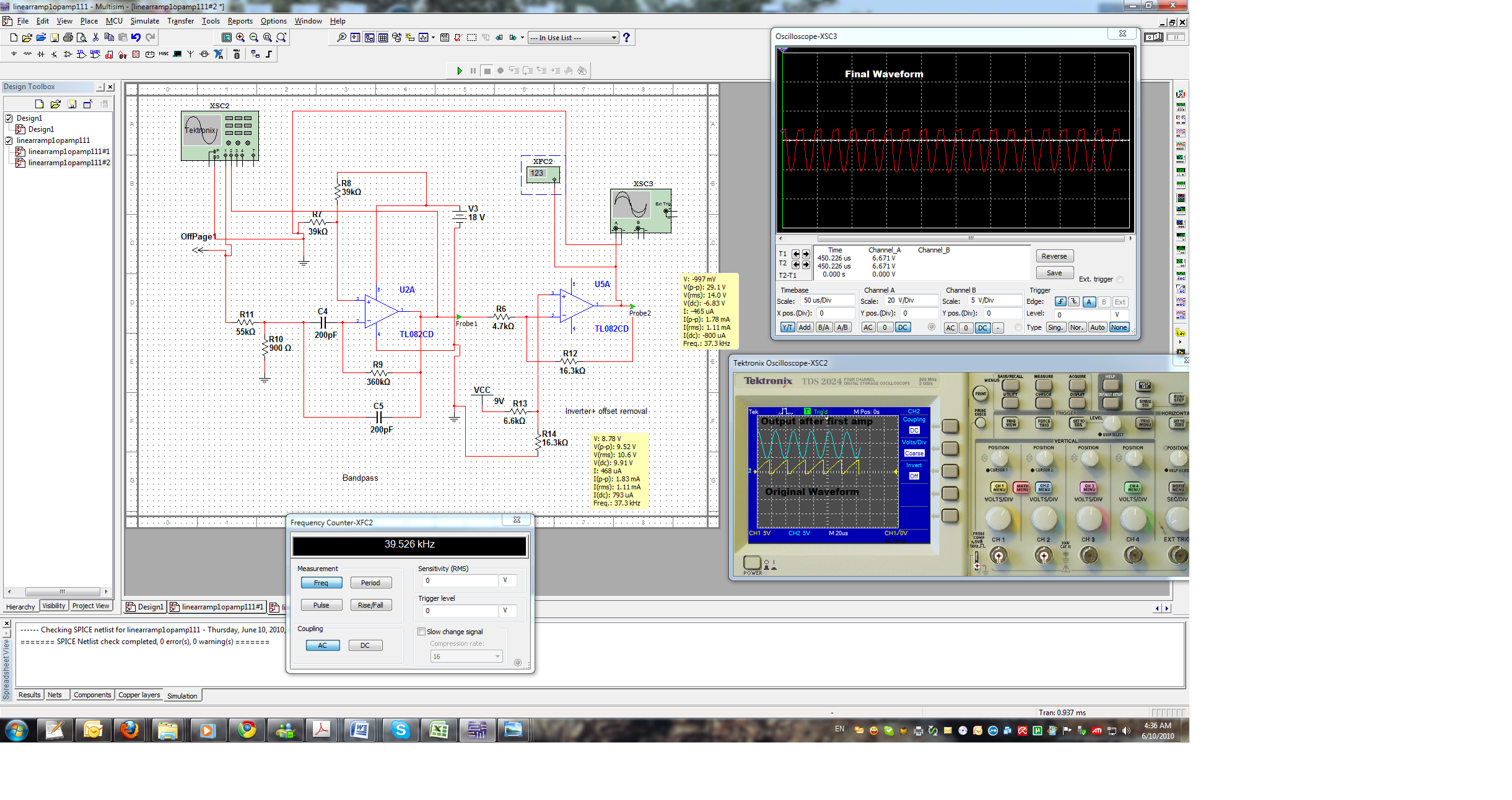

I apologize I didn't respond earlier, but I wanted to try everything before coming back for obvious questions (for most of you). I've tried all day to fix the problem, without any success.
At the moment, it works nice in the simulation software but fails in reality. The block diagram I have:
linear ramp-->analog switch-->bandpass filter (for sinusoid)-->inverting+dc removal block.
While the first three work fine, the last two don't work no matter what I do.
Please review the attached schematics and pictures from the actual scope.
It seems that it doesn't matter how I configure the loops/filters, the dc offset is always there and the gain is negligible. At this point I'm open to any suggestions if you have of circuits that might work, as the deadline is approaching and I've spent +72hrs just on this filter-amplification configuration.

From left to right: pulsing the wave packet after the first stage, the wave itself inside the packet after the first stage, and the wave form after the second stage.

Your Multisim software makes a huge mess of the schematic since it has ground wires all over the place instead of ground symbols, 'scope wires all over the place instead of labels, wires all over the place since no single wire is a straight line and millions of connections since it does not allow 4 connections at one point like a real schematic has. I am glad that you turned off the chicken pox dots.
The schematic shows two completely separate TL082 dual opamps with only the first opamp used in each one. The second TL082 has no power supply but somehow has an output that is much higher than your power supply voltage for the first one.
But your real circuit barely works and is extremely distorted.
The value of R10 seems to be much too low.
It doesnt make any sense to me. I've tried it also when R10 was 10k, it was about the same. I don't understand how an offset+inverter configuration have no affect on the actual circuit. I thought that using additional 18v source just for amplification should be sufficient for~16-18 Vp-p, but it didnt do anything except making things worse. The dc offset-inverter is in accordance to the typical design. Do you have any suggestions what I should try next?
Hi again,
The values i gave you were for a single stage. Lets get that working first, ok?
What does the output of the first stage look like without using the second stage? Is it a clean sine wave now? It should be. Get that working first. It should be centered around 1/2 of the full supply voltage. That puts the zero at +9v with an 18v power supply. If you show a scope picture, please label all the axis clearly.

I've tried the suggested values and it was precisely centered at 9v, that's pretty cool. Now I just need to get it down....(remove dc offset).
Hi again,
Can you use capacitor coupling on the output? That may be enough. The cap will remove the DC component.
It worked, I've used an RC (cap in series an 680ohm resistor to ground).

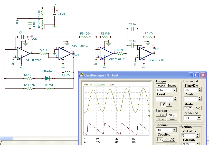

Attached sketch should produce a reasonable 40KHz sine from a sawtooth. OP1 and 2 produce a 40KHz sawtooth, with OP3 as an inverting buffer, and OP4 as a bandpass filter with a Q of about 6, and a gain of 70 at the centre frequency.
Not exactly 'generator' quality sine, but should be OK for your application.
Edit: The circuit values are for a 24V DC supply. For an 18V supply (2x 9V), mentioned earlier in the thread, change R5 to 6k8 and R11 to 10K.
