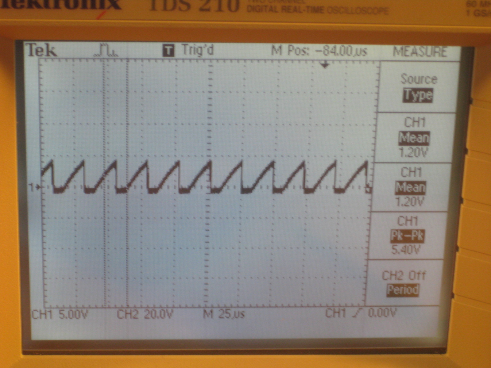

I've attached schematics of the filter and a picture of the incoming sawtooth wave from the linear ramp.
In the mean time, I've added an LC before the filter to covert the sawtooth. The resulting wave is ok, but I dont think that the filter is centered around 40kHz anymore. I'm trying to design a 39-41kHz filter.

As you can see from the input wave picture, Vpp=5.4V with center frequency of 40kHz (but it is a linear ramp so varies +-1kHz).
That being said, I need to filter the incoming wave a little and convert it to a sinusoid (if possible). The output amplitude-- the higher the better as long as it's in the frequency range. I'm using it for my ultrasonic range finder.

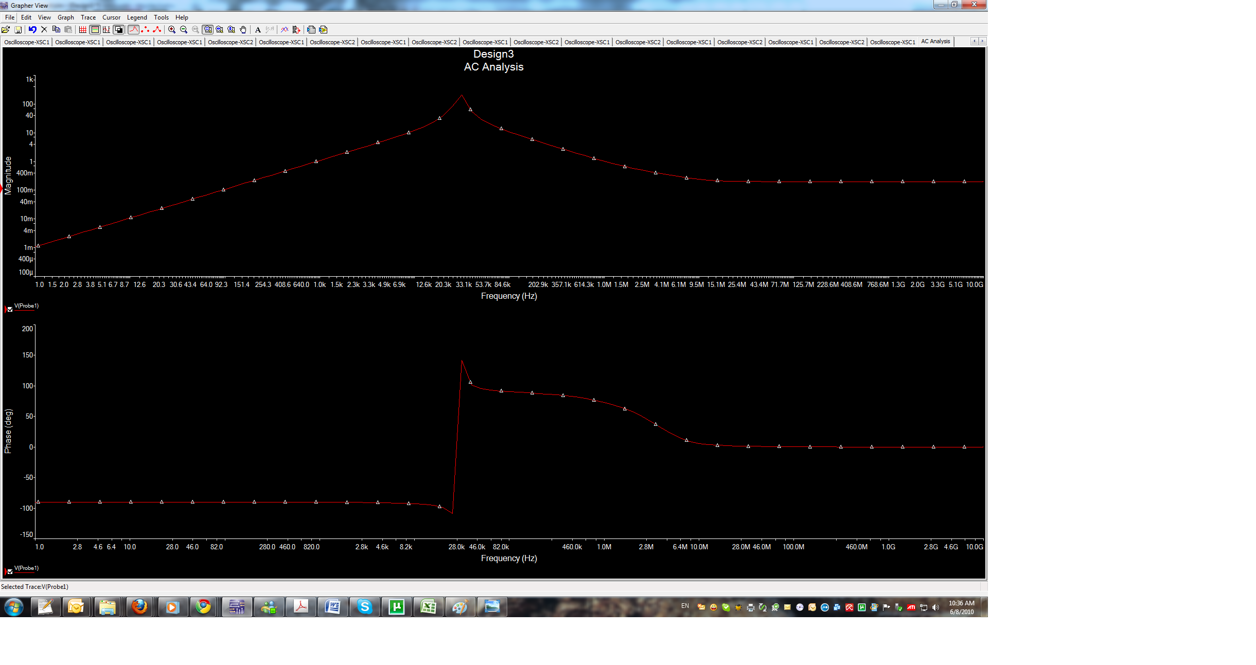

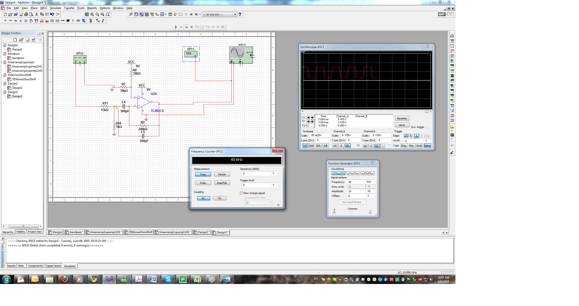

The simulated filter with a TL082 in multisim is attached.
I think this waveform is good enough for me, only if I could make it more narrowband (39-41kHz). Any suggestions?
I've attached the schematics in .png and in .zip (for multisim).

A TL071 is a single low noise opamp. A TL082 is a dual opamp using the same opamp for both but not selected for low noise.
Look in Google for tutorials about how to design a Multiple Feedback Bandpass Filter to narrow the bandwidth.

Can't you see that the output of the filter is clipping like crazy because the input level is way too high?

@AudioGuru, I see that it is clipping, but I rather have clipping than lower Vp. About the attachments, I'm using PowerArchiver, and it opens them fine when I click on the links. I'll try to figure it out.
clipping produces a lot of harmonics that mess up the bandpass filter.
