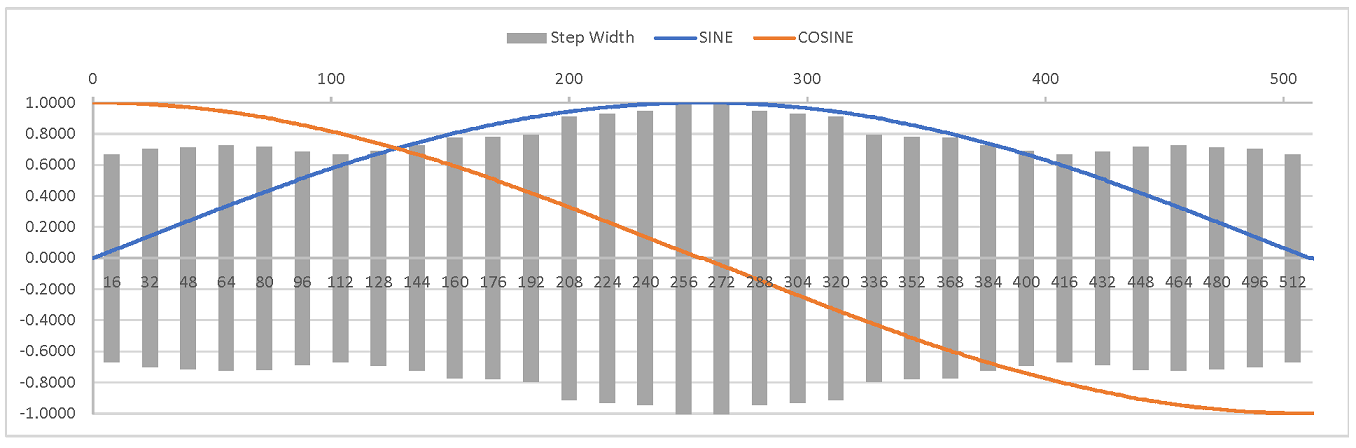

I have a 2-phase stepper motor driven buy a pre-built MCU with TMC2130 stepper motor drivers. Based on measurements it appears that the stepper motor doesn’t microstep in equal amounts (some are 50% wider than others), and I’d like to improve on that.
The microstepping is accomplished by PWM of the current to the two stepper motor phases, following a sine/cosine current arrangement. Based on the measured results, one of the two phases is providing more magnetic flux than the other, resulting in unequal length microsteps. Interestingly, a change in stepper motor made almost no difference, therefore I feel that the unbalanced output is mostly due to the driver IC, not the stepper motor itself. I have not measured the actual currents to each stepper phase, it sounds like I'd need a decent oscilloscope to do that.
I can't solve this with software, as the stepper driver uses the same curve data internally for both the sine and cosine current waveforms, just offset by 90 degrees. Any changes would apply to both. So all I can imagine doing to equalize the two are:

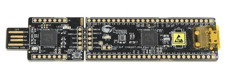

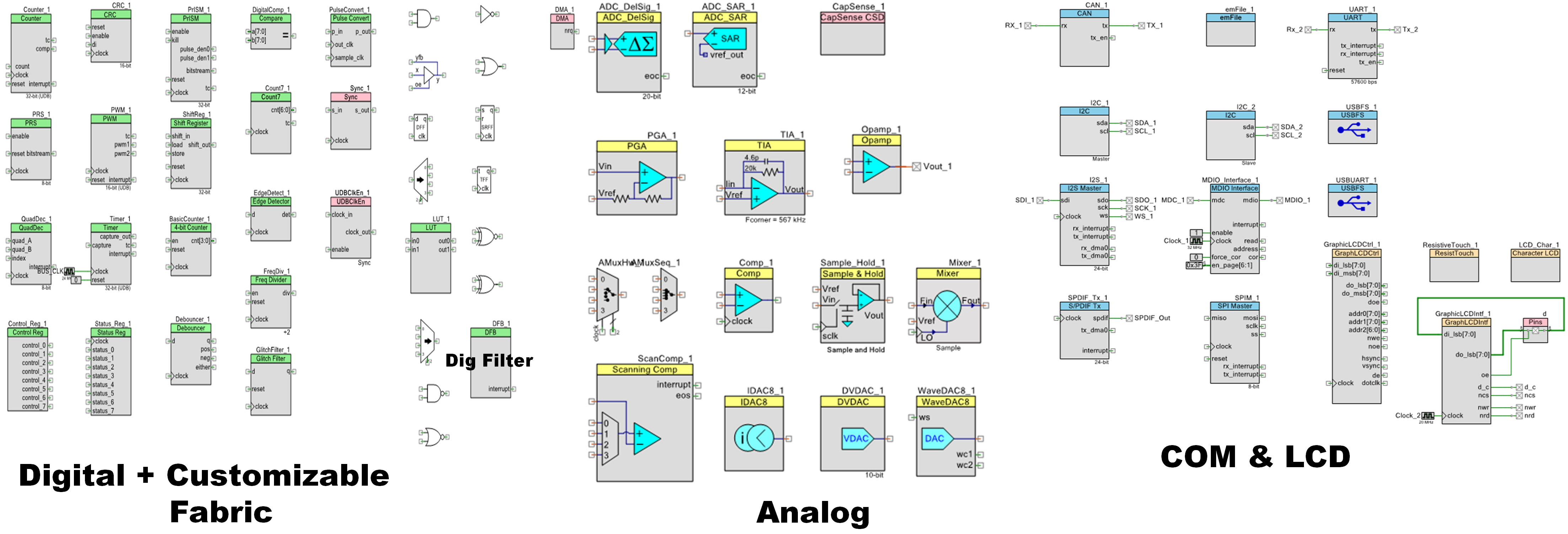

Think of PSOC as a pile of components and a breadboard rolled up into a chip.
You drag and drop the components (a component in PSOC lingo is an onchip resource)
into design area, double click it, and config it, like for a counter its # bits, use enable, or
an OpAmp, its power level and mode, a follower or a regular OpAmp... Then you use
a wire tool to either connect it internal to other components and/or to pins. Then write code
for any component that needs real time changes, like a timers period or a clock change.
All components have an API library, so you just call those f()'s in your code to perform
tasks or read their results, like A/D. Here is whats onchip, in many cases multiple copies -
Excellent starter board, $ 15, CY8CKIT-059
There are tons of training videos but here is a couple of youtube starter videos :
A series of videos
Note PSOC has the capability using schematic capture and/or verilog to create custom components.
There is a library of user activity doing this, like DDS, CORDIC component, 74HC look alike logic components,
etc.. One can import these into your design catalog and use them. Great stuff.

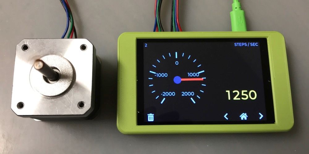

An aside, here is an interesting analyzer for steppers (using Raspberry Pi Pico)
https://github.com/zapta/simple_stepper_motor_analyzer

I haven't tried swapping the phases. The way I've been measuring this so far is based on the TMC bulletin, using a laser pointer attached to the stepper and measuring the length of each microstep. I'm able to correlate the measured distances to the increment number in the TMC2130 step table, so I suppose I could determine which phase is out of whack that way, but it's pretty cumbersome.
I did see zapta's "simple stepper motor analyzer" on the duet forum, and had messaged him but not heard back. The only boards I've seen for sale are on Tindie in the UK, but I'd be up for building one. It looks like the rPi that it uses is actually available, so that's good. Though my SMD rework station seems to have pooped out just by sitting, so that needs to be fixed again first. Grrrr.
