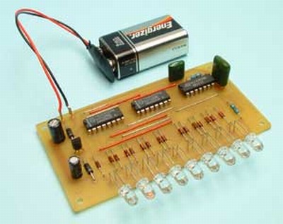

hey Timbo,
On reading this thread I thought you'd like the look of this electronic kit from Jaycar Electronics www.jaycar.com.au and the kit number is kj8236 (retails for $14.95 ) and the instructions kj8237 ($2.00). cheers Bryan
