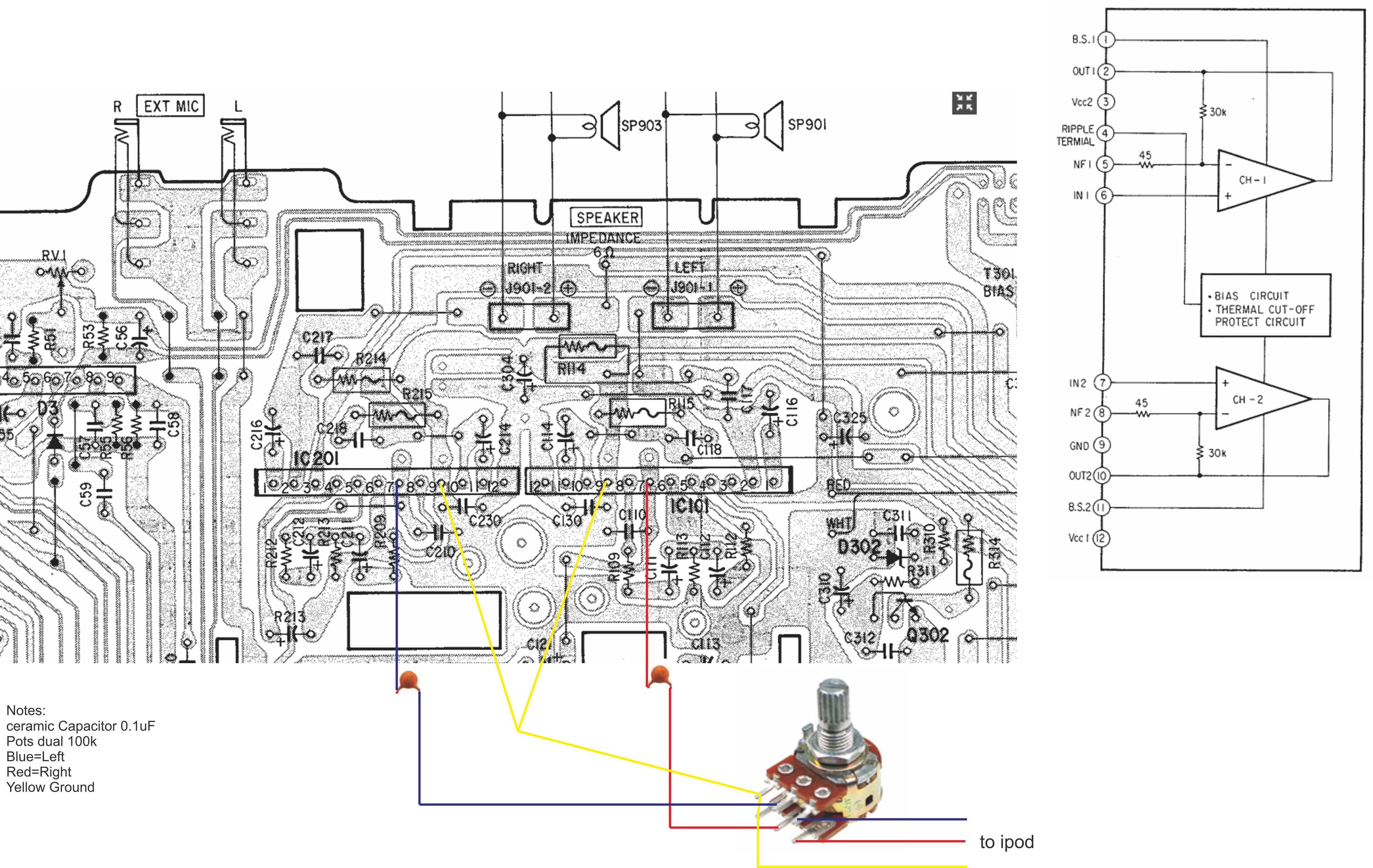

i try to add an aux in to my old boombox, the reference from here https://cocodrilabs.wordpress.com/2012/04/05/installing-an-auxiliary-input-on-a-stereo/
i already got it working, but the problem is the potentiometer(volume). Only one channels work
my boombox has 2 IC Amp, one for each channel. I already try to connect the source(ipod) directly to the amp (without the pots), work like a charm. But the sound is to loud and distorsed

check the pot for failure
COnsider using the fixed resistor divider.

Recheck your wiring with the pots in place. Since both channels work with a direct connect, a mis-wired pot is the most likely problem.
You also forgot to insert the 0.1 or 0.22uF caps (try them both, separately, for what you consider the "best" sound) in series with the signal from the pot(s) to the input of the amps (as per the instructions you included). The caps are necessary for isolating the iPOD circuitry from the amp inputs (among other issues).

i already put the capacitor hehe look at the attached picture :)
i also tried 3 different pots, same result. im using a stereo test app in android to test the left right channel

You more than likely are wiring your pots in wrong. One end of the pot goes to ground. The sweeping tap goes to the amplifier inputs and the other end connection goes to your signal input source.
If its set up right the sweeping tap will have a range from common ground (Zero volume) all the way up to full input signal.
